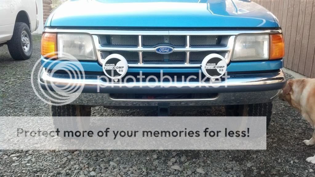

Since my new lights don't fit the OEM holes and brackets...I decided to rip off the airdam and install the new lights on top of the bumper. Will post pick when other new light comes in. Being an idiot I thought they came in pairs so I had to order another one from Summit Racing.

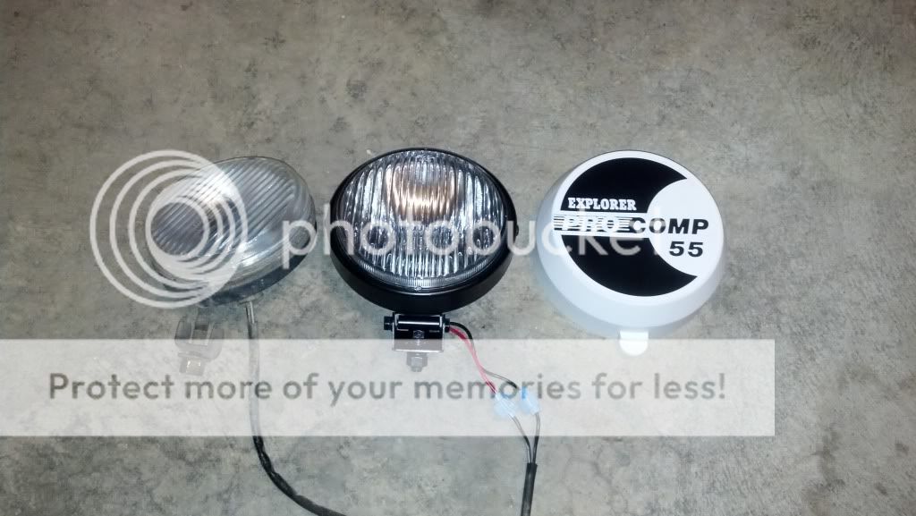

Pic of old Hella OEM light with new light. OEM light is 4" Dia. New light is 5" Dia.
Put the air dam back on with some stock junkyard replacements and maybe add 2 more above your bumper
I actually tried to put these 5" dia. lights into the 4" dia. holes in the airdam...no go. I went as far as cutting out a larger hole in the plastic, that went ok but the metal brackets would not allow the larger dia. light to fit. I tried drilling new holes into the brackets to no avail. After that I took a large screwdriver and ripped the airdam off and then cut using a dremel the 6 bolts that held it on. I threw the airdam into the burn barrel and lit her up. Bye bye airdam :thefinger:. Might install more lights as time goes on but not a priority yet. By the way...the metal mesh covering the rad. is from a roof gutter meant to filter out leaves. I don't care, looks ok and protects the rad. from sticks, rocks and such.
