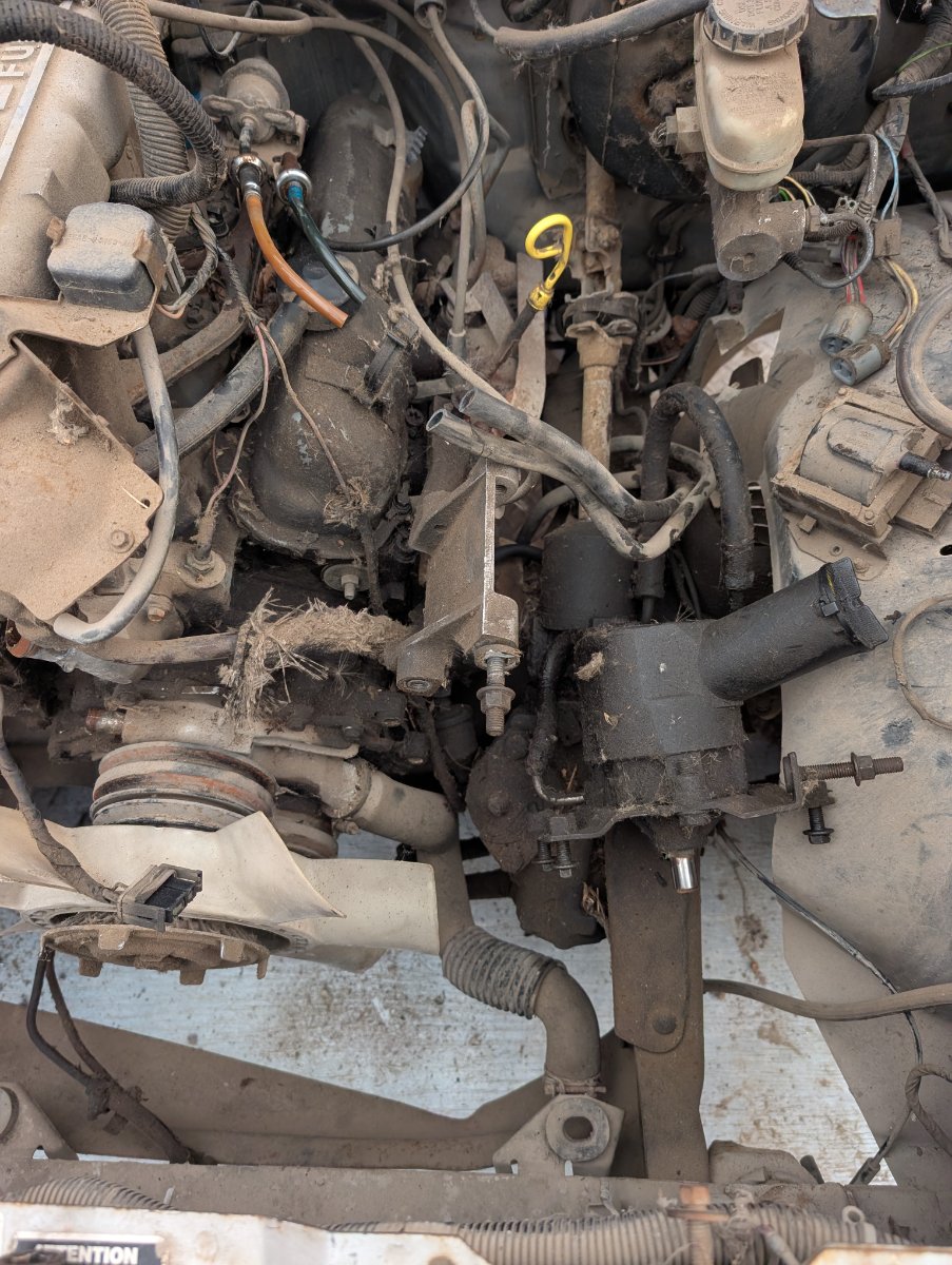

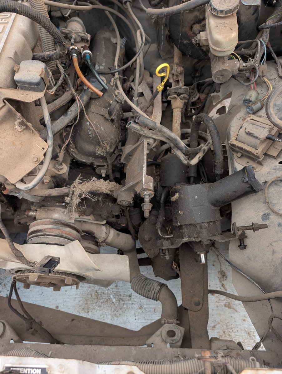

A couple pics of what I'm starting with. I did lower it down to work on it. I will be pulling the motor and wiring harness to give to a friend who is putting it into an English car. The a4ld was rebuilt not long before the truck stopped running. That will go into my pinto behind the 2.8l.

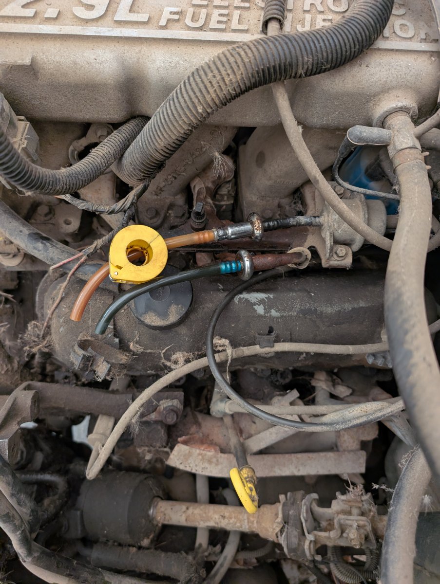

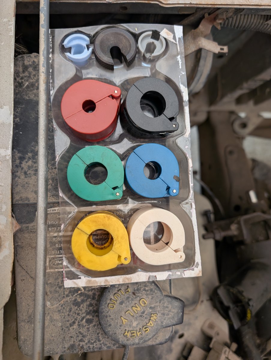

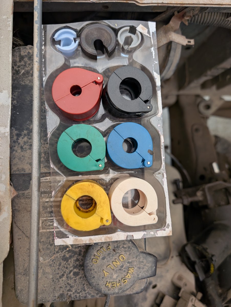

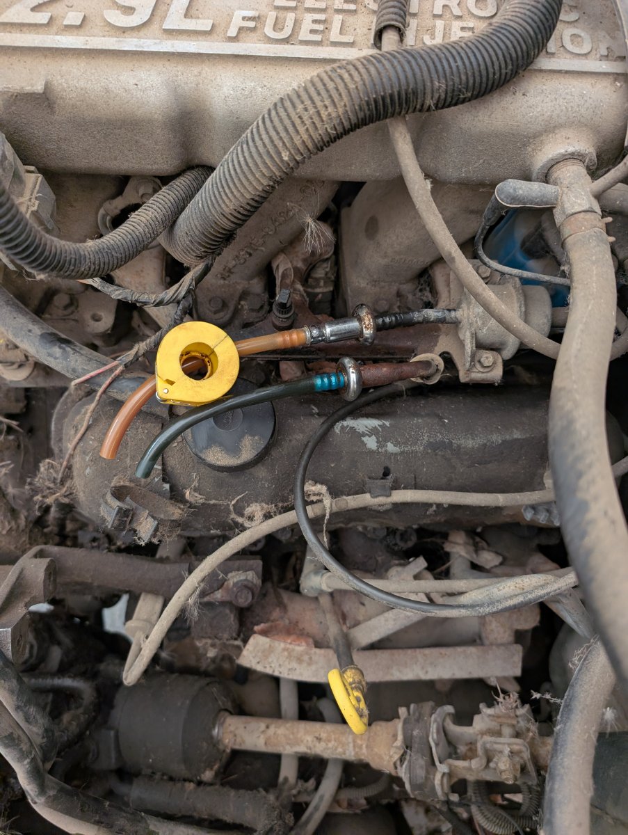

I have to remember that I'm not keeping the truck, it's going for scrap. Case in point, try to disconnect the fuel lines.... I spent 20 minutes looking for the tool. Spent 20 minutes trying to disconnect. Got one disconnected fairly quick but the other won't let loose. Finally it dawned on me and I used a knife to cut the lines....
So i tried to get the top 2 bolts loosened on the bell-housing. I must have lost a lot of strength over the years because they would not budge, even with another wrench as an extension. I'll see if I have a pipe that will slip over the wrench. If I have to I'll cut the one end off a cheap wrench.
I did find the tool for removing the power steering pump pulley. Even found a spare one still in packaging. That went smoothly.

Oh, and I found 3 other unopened fuel line disconnect tool packages as I was looking for the pulley tool...
well they do say the quickest way to find something is to start looking for something else...

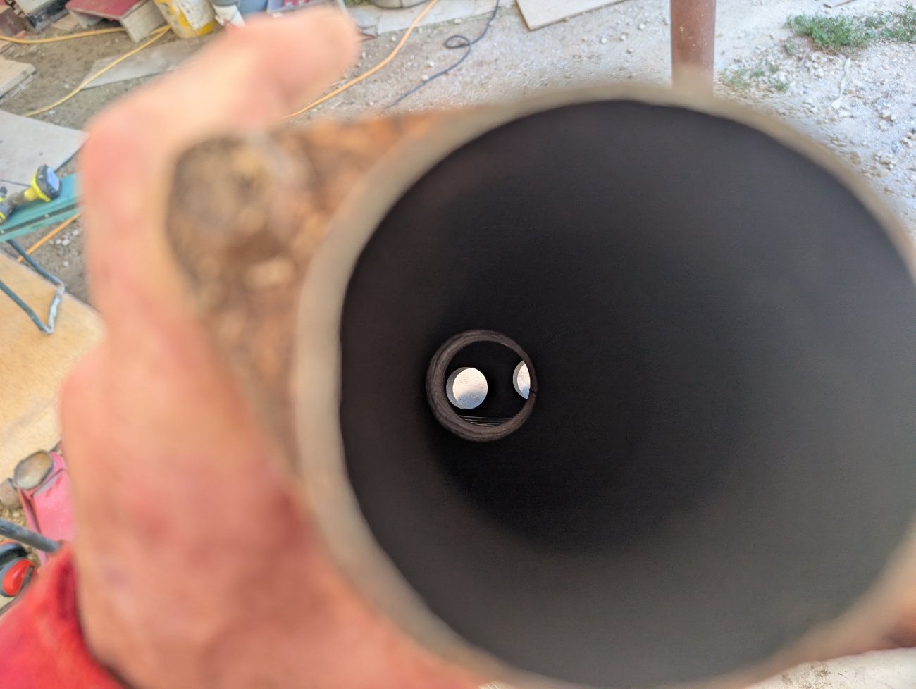

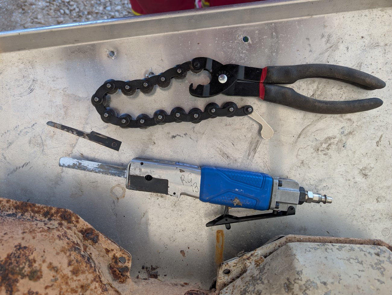

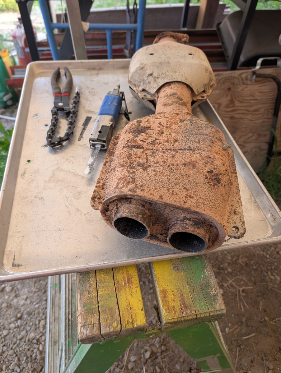

Today I spent an hour or 2 cutting out the cats. I wanted to cut as close to the cat as I could so the next guy can easily weld a dual exhaust if he so wishes. I remember seeing a air hacksaw recently. Do you think I could find it quickly? No! I had to search high and low, but in the process found almost a dozen other air tools I had forgotten I had bought. Finally did find it tho. I modified the end guide so I would use almost the full length of the blade. That worked pretty good. The blade got dull before I finished my first cut, so I dug thru and found some old 12" hacksaw blades, cut them down into 4.5", 4", and 3.5" lengths. They fit perfectly in the air saw... But the blade were so brittle I could snap them in my hands. Disgusted, I drove down the the store and bought some new blades. That did the ticket. So I spent probably 2.5 hours on this so I could harvest and sell the cats. When I looked inside I could clearly see thru them... Shit! I remember now I gutted them when I first got the truck....
The tools I used;
5he top one I can't remember the name, maybe exhaust tube cutter. It works great!
The bottom one is the air saw. It works but seems to take forever. It's a body saw so probably not meant for thicker gauge metal. But it did the job much easier than a regular hacksaw.
I was surprised how thick the metal is on the inlet to the cat, looked like 120".
And the view thru....
