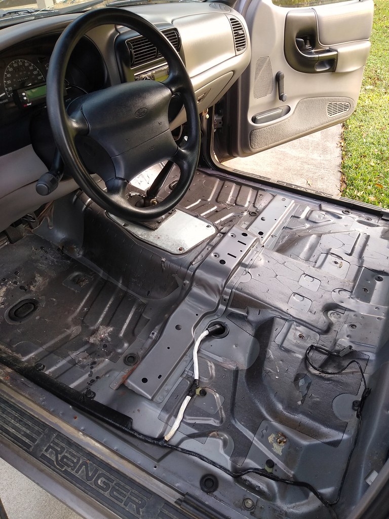

I can show you what to expect. Here's my 1996 single cab during a carpet replacement.
I got the new carpet from Rockauto for around $125. Well worth it.

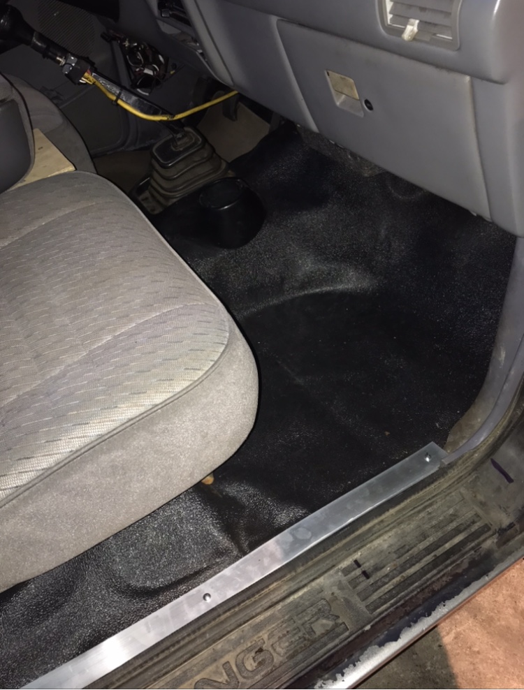

The metal is no meant to be washable, so, a coating would be an answer to that problem. I would remove the body mount covers and make sure there are 1/4" holes drilled into the corners of the mount so water can escape. Probably towards the back of the truck would work better in a salt state. On my 1985 B2 I noticed they were there on at least some positions.
I ran mine with a bare metal floor for a few years, just last fall I put a new vynil floor in. Got a box of sticky sound deadner squares (like dynomat, just not that brand-think it was “kilmat”) and coverd the floorpan after doing some patching of the floor. Then put in the new vynil floor covering. Bought both off of fleabay, think the vynil floor was $140, the box of kilmat was about $50. I still have about half of it left. It is much quieter now, cant speak for heat insulation as its never been a very warm vehicle and usually remains in hibernation during the wintet, mostly due to wanting to keep it out of the salt bath. It took me most of the day to do but I do feel it was worth it.
Most newer vehicles have wire harnesses that run under the carpet anymore. You’ll need to do something to protect them if you decide to pull the carpet.
