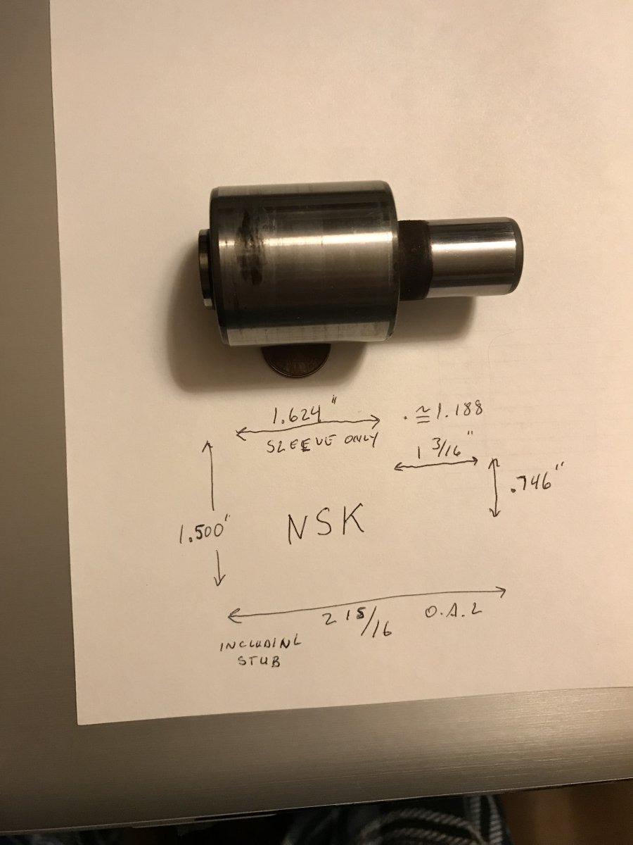

this is the timing cover from my 367,500 mile 2.3, Duratec, 2005. the bearing is still in good shape, they must be quite durable.
but it's there! So I must remove it. :stop:

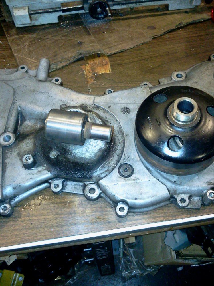

instead of doing it the easy way with a 3 jaw puller I decided to turn a previous fan nut into a tool.
drilled and tapped a 10 x 1.5 hole thru it. the OD is 36mm.
the threads inside the bearing shaft are 3/8 NC, I put a short bolt in there to push against

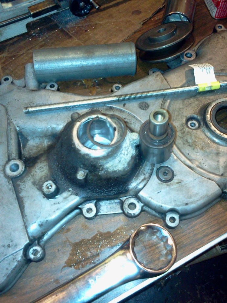

with the pulley off the internal C ring/snap ring is removed, not shown.

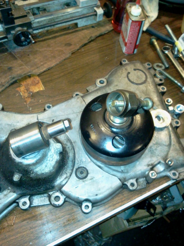

started with a 36mm socket, it wasn't deep enough and later switched to longer pipe.
bolt is threaded into the bearing center stub, held the bolt head and screwed the nut down to push the cover away.

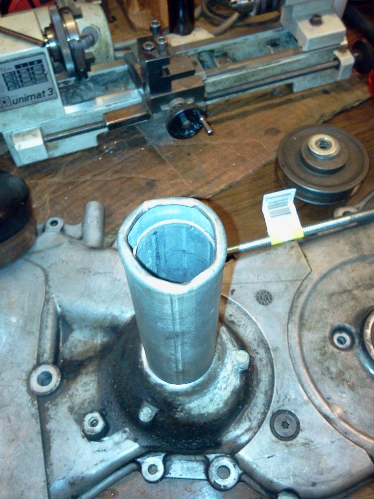

added a pipe, pulley, length of threaded rod for more room.

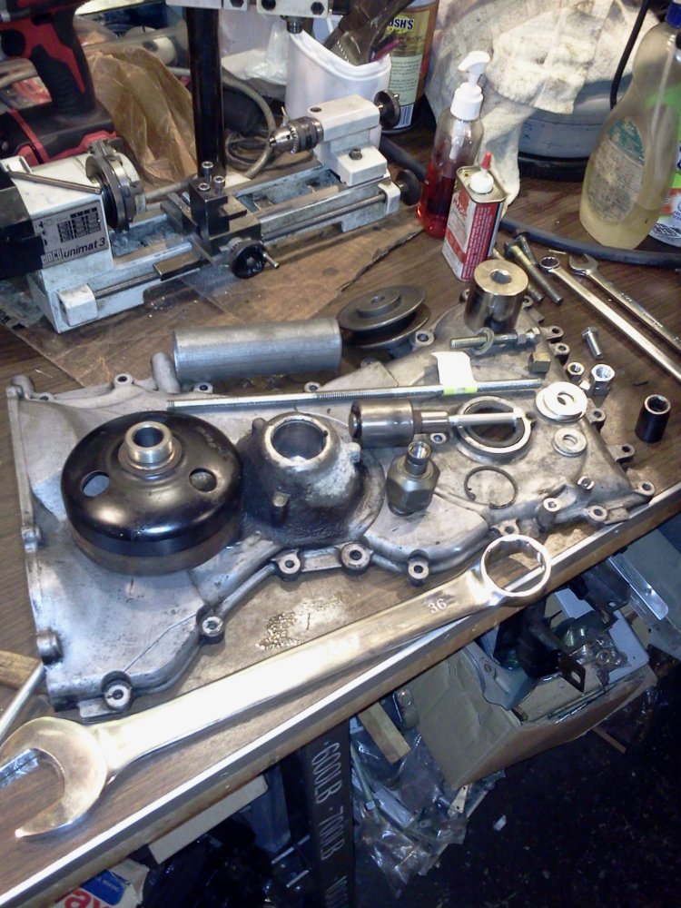

everything laid out
