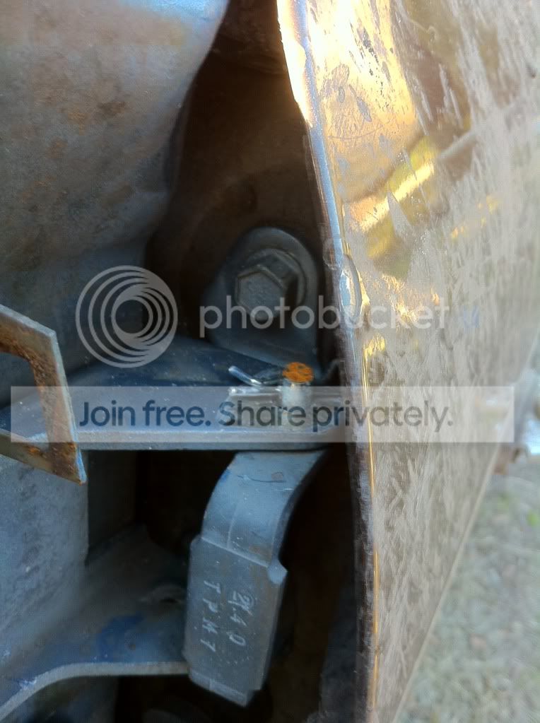

heres my removable doors

i assume you rebushed this in each spot? my bushings fall out all the time though:icon_confused:
Removable doors write up
with an open setup like this you dont want the actuator rod exposed...it can be bumped and opened when flopping or on hard bounces, fabbing a cable or protected link rod is still easy to do though will take longer but imo worth it.
This is something i do plan doing, but have a few questions first...
I have noticed alot of people are putting the bolts in from the bottom to the top, with the hitch pin at the top. Any specific reason? Personaly i would think putting the bolt in from the top and hitch pin at the bottom would be a more secure way... no?
i agree, maybe a washer underneath the bolt head too. that way you dont have the metal getting chewed up as much, maybe even a bit of grease on it too.

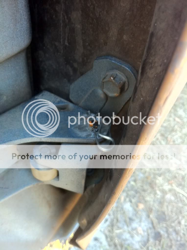

Has anyone worked on a slip joint style hinge yet?
Like this.
Like this.

i tried some home made iterations of that but it did not work the way i wanted...and never pursued it further as the junk i use works fine.
the slide hinges did not work out like i had hoped for the same reason the pins go up and down and not both down.
the curvature of the door and the hinge bolts on the door interfere a bit making sliding a decent pin in difficult or impossible if you properly bushed them.
by using counter sunk type bolts with an allenhead you can pop both hinges from the top sothe keepers are on the bottom.
you can make a setup likethe hinges jester pictured but you have to have a pos ugly dont care about the paint truck like mine along with modded fenders to keep from messing the paint up and dinging the upper body line.
