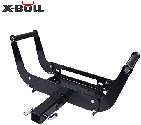

I wanna buy this...
to sit in the 5th wheel bed rails....

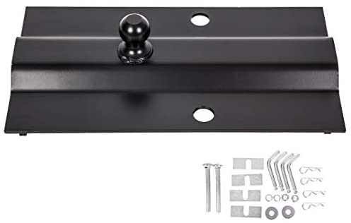

Take this....
and hook it to the hitch ball....

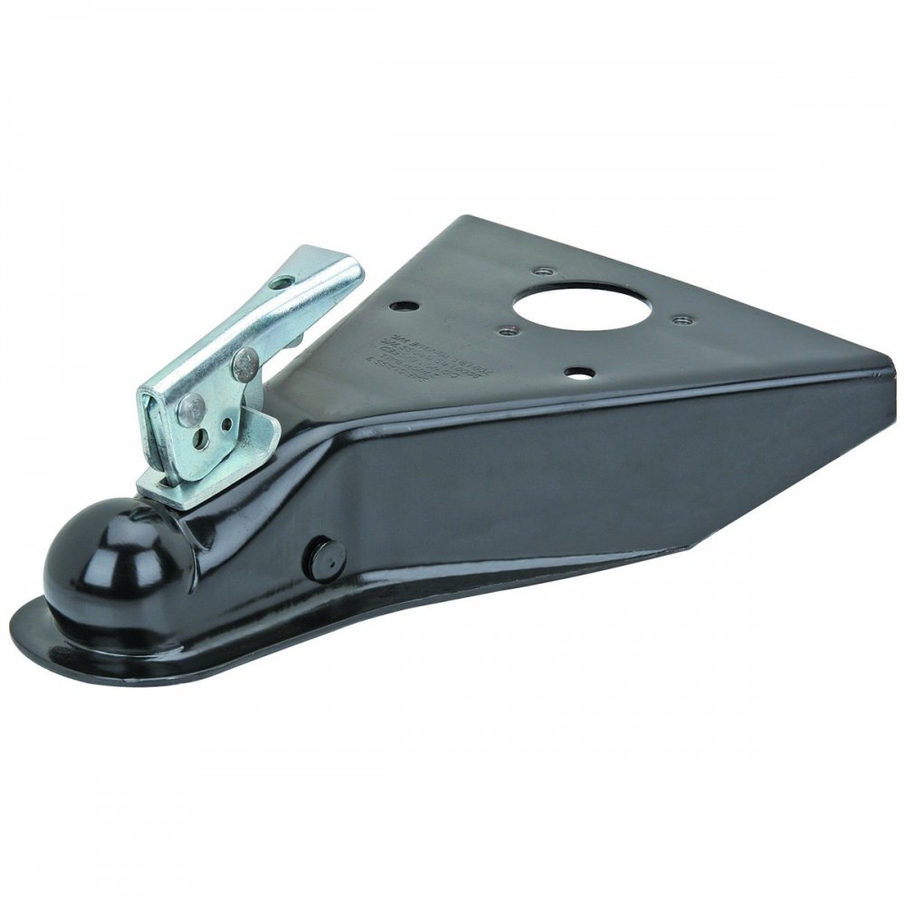

Then bolt this....
to the coupler...
then slide this into it...
and obviously mount the winch onto it.

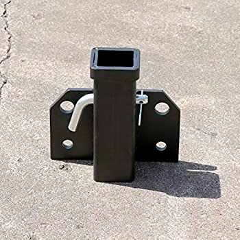

I wanna buy this...
