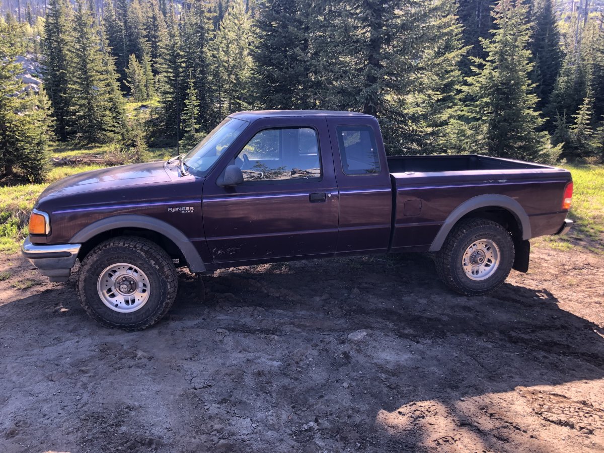

Not going to ask how to put larger tires on my 94. I'm currently running 31 x 10.5 BFGoodrich All Terrain T/As and would like to move to a more daily driver tire. Dont get me wrong, I like this size but I need something that can make long highway trips in snow as well as do a small amount of gravel/mud on hunting trips. Suggestions on size, brand and type? If this is like the Tundra page I frequent, peolpe roll their eyes at another tire question. Please point me to any threads that might help as well....Thank you

Thank you for your input. Went with the 31s in the backcountry had a lot of good luck with them on my Tundra. The ranger is a new rebuild and got her into the mountains. Did well and the tires were great. Will know more after this winter.

The 31 is the size I finally went with. Thank you
