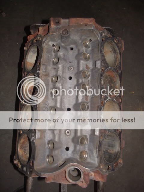

I just sent a spare block off to get bored .30 over to get ready for a stroker kit. I will try to get pictures of that loaded up later tonight or tomorrow. Let me know what you guys think, or if you have any pointers about these old Foxes.

It's number 279 of 743 (IIRC), it only has 101,000 miles but it wasn't maintained the way that it should have been, which is why it is going in for a rebuild. The block came out of a 91 crown vic so it is a roller block. Here are some pics of the block so far:
When I first got it:
Notice the rings in the cylinder wall
Here it is after a nice bath:
Here it is after the .30 over bore, a world of difference:
Here is the cylinder above with the rings in it:
I have more pictures than this, but I think you get the point. I have to figure out what cam I am going to use.
