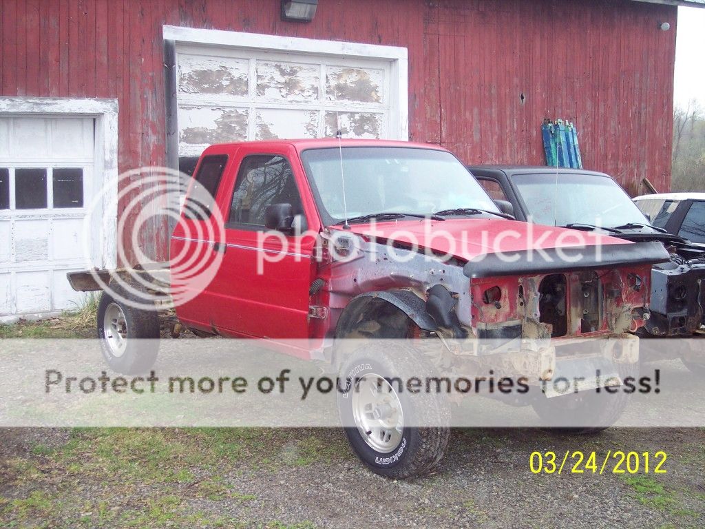

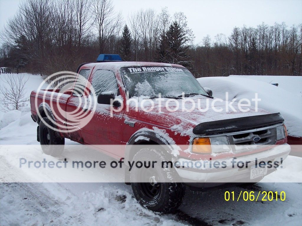

someone mentioned this truck was in a magazine? got a pic of it b4 i hit the tree?
here is the exact pic that was in the mag , i want to say it was like the May of 2009 issue of Off-Road in the letters section

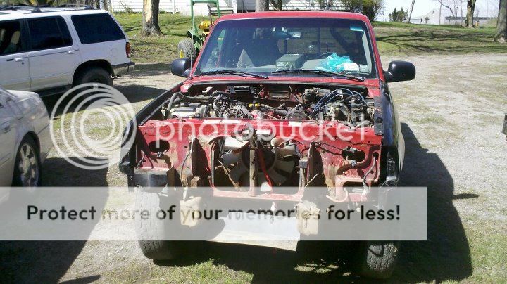

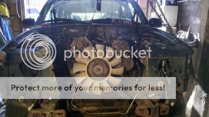

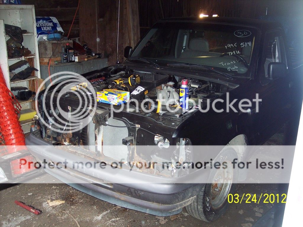

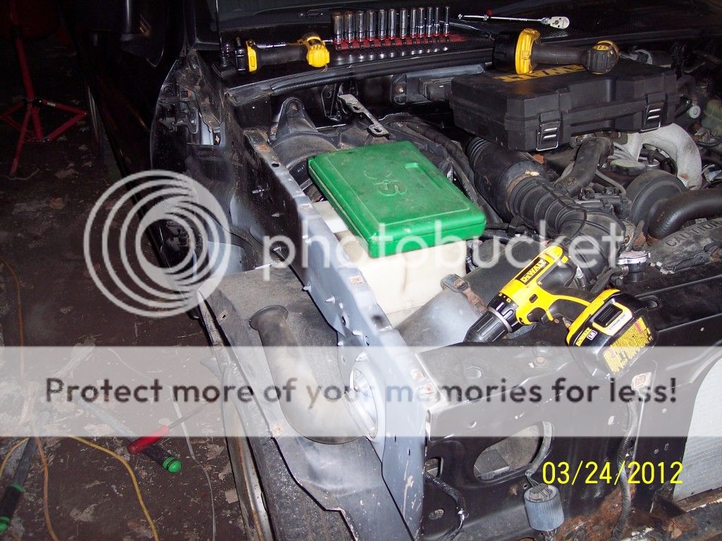

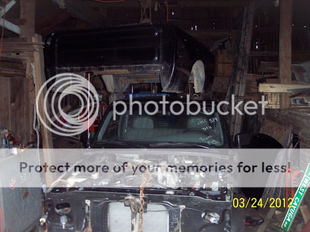

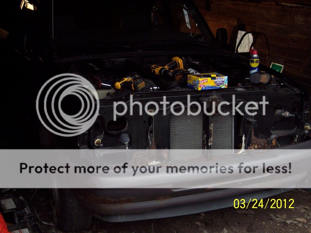

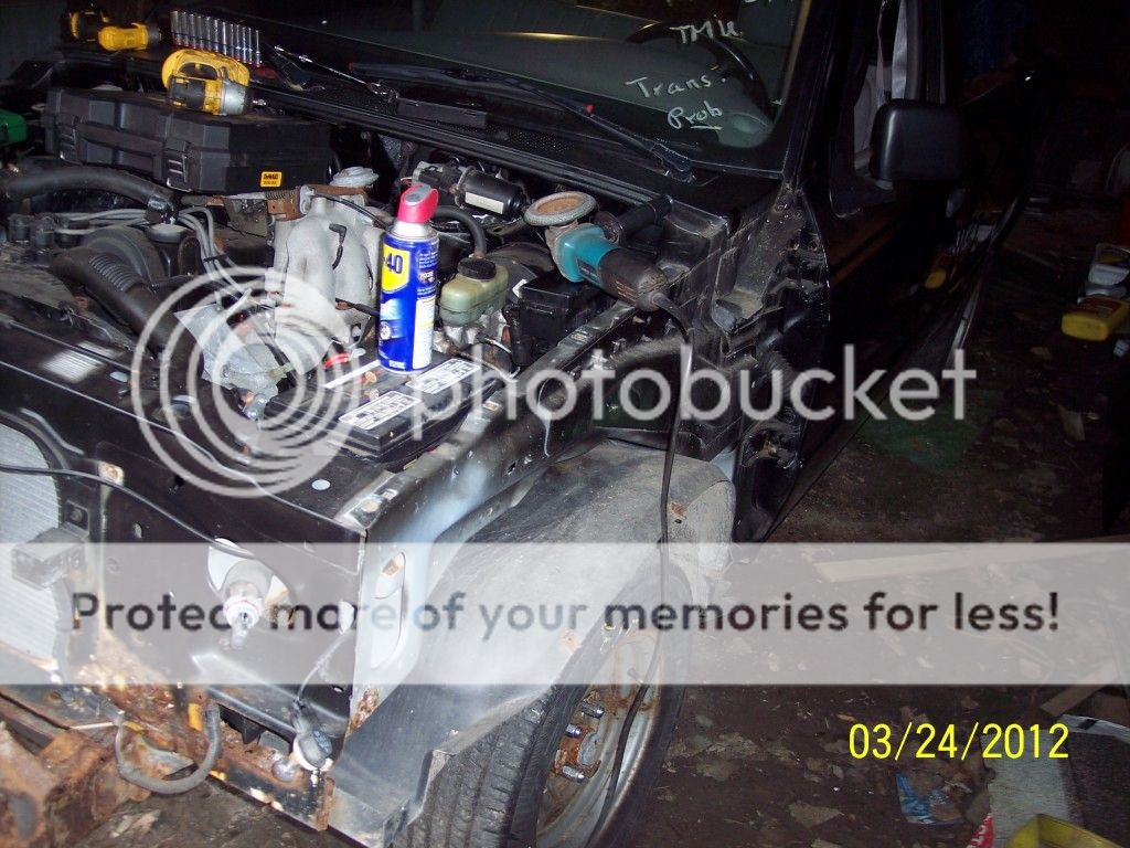

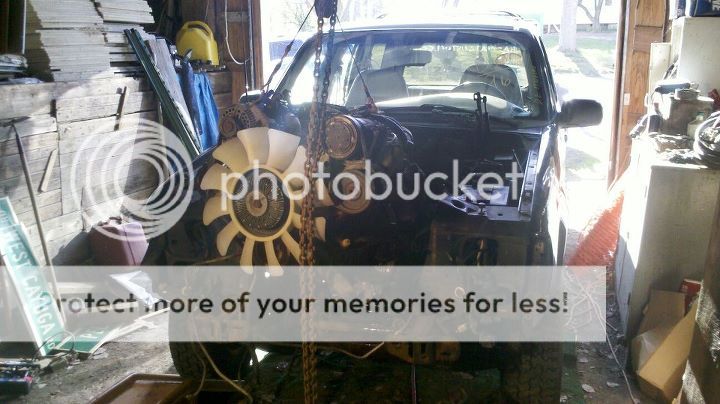

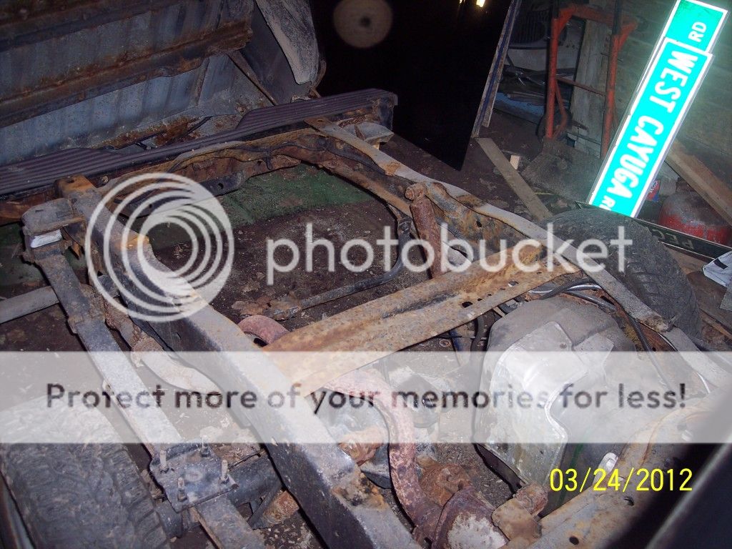

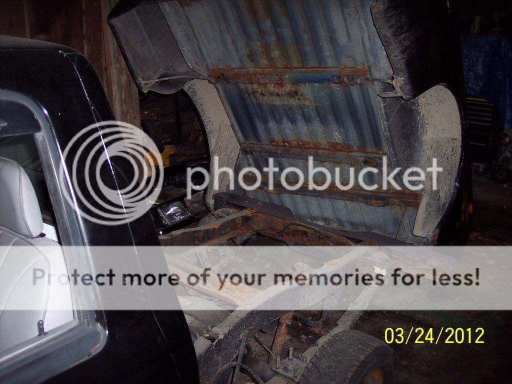

and here come the progress pics , not even gonna bother labeling them , would take too long
and there is all the updates so far

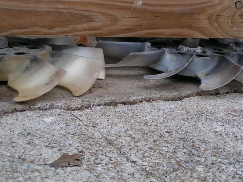

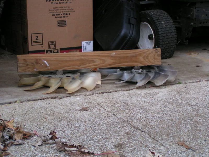

if you have the double row radiator in your Ranger, make sure to swap out the Ex fan with the Rangers.....I ate 2 rads because I didn't know there was a difference between them....

do i just measure the thickness of the rad to tell the difference ?
if you have the "thick" radiator, the end tanks are the same, the "thin" has one wide tank and one skinny one.....
as for the difference in the fans.....here you can see them side by side....

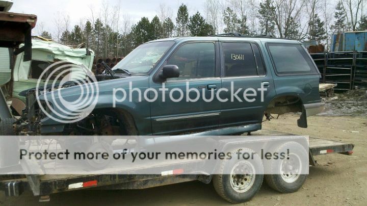

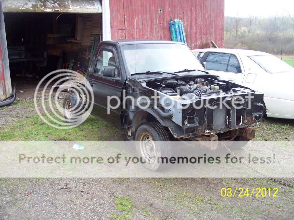

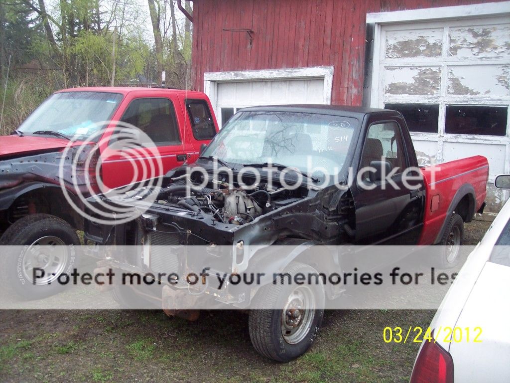

here are some pics from when the Exploder went in for Scrap , hopefully i will have more progress after this weekend when i do some more work to it
got most of the wiring put back together this weekend , got 2 connectors left to hook up , once i start a full time job and am home after i plan on getting alot more done , plan to have it running/moveable by the end of may
