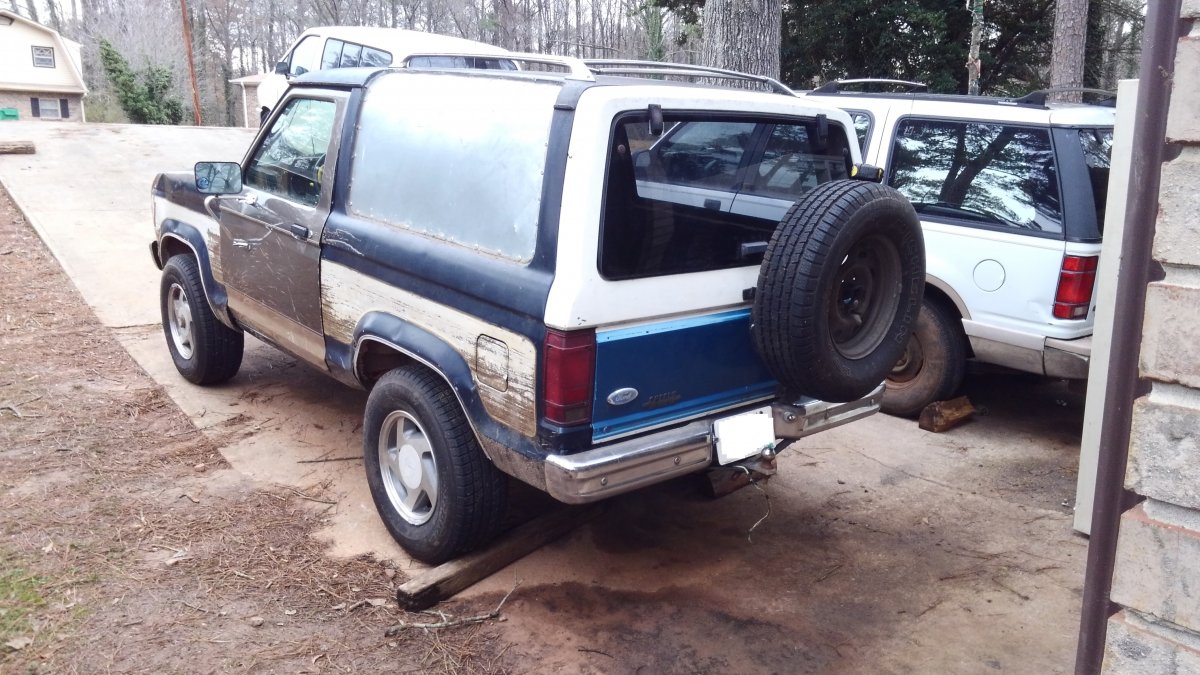

How hard is it to remove the rear side windows? Mine are leaking and the local shop wanted $600+ to remove, reseal and replace the rear windows and install a new windshield. I don't have that laying around plus if there is any rust problems I'd like to treat and paint or cut out and replace.
So how bad is it to remove the rear windows? Any pro tips? I already have the trim panels off. I see there is studs with nuts but the 35 year old gaskets and sealant kinda scare me.

Thanks for the feed back. wildbill is correct. The molding is part of the window. I got a hold of a service manual and it clearly shows it's part of the window. Thanks Ford but they probably never meant for these things to still be running around.
However as someone pointed out the bolts might be loose. They were all VERY loose. As in the nuts went in at least their own thickness again. So it's sitting the rain now and I have my fingers crossed it's not leaking.
SUCCESS! I got the window out. Took about 2 hours and knowing what I know now I'm still not sure I could get it out any quicker. Thankfully it's solid and there is no rust around the window. Going to clean it up, repaint the lip and reinstall. Although much to my dismay the only obvious issue was the drip rail which doesn't explain the leak coming from up higher. I suspect the window was the minor leak and real culprit is the shrunken seam filler at the top of the rear hatch opening. I already planned to address that. I'm tempted to remove the other rear side window and have the body shop repaint the top and A-pillars. I like the look of the rest of the truck but I really don't want a rusty roof.
