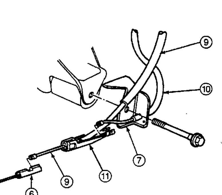

Well, thanks for all the input. Here's where I stand:
Cables are routed correctly (thank you for that). I've gone over that a bunch of times going thru images and the shop books and the right side cable is still about 5-6 inches too short even with the equalizer in place. I've stretched the existing front cable as much as I can,
As mentioned earlier in this post from @2011Supercab there is some extra cable available in the ratchet mechanism. If I remove it to access that extra cable, I may as well replace that piece of the puzzle as well. That part will be here Monday.
Today. I'm headed the the pull yard. They have a couple of my generation Rangers in the yard that I have picked over before, just to check and see what they look like - plus it'll get me outta the house for a few hours.
If none of this helps to resolve the issue, I'm just going to splice in the extra cable I need and call it a day.
I'm not gonna beat my head against the wall for an extra six inches -- that's what she said. ;brownbag;

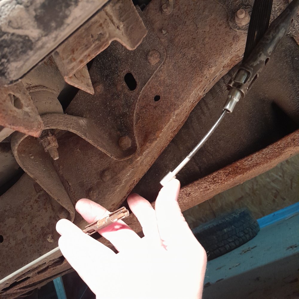

Solved...I think...
The pull yard helped immensely, but that's for later.
The mystery for me was two pieces of hardware that connect the left cable and the right cable to the equalizer and this one other part that rarely gets mentioned....see images.
This guy gets connected to the front cable and to the rear left cable after the rear left cable gets pushed thru the front slot on the equalizer bracket.
After this is done...it reduces the distance to the left rear cable by about an inch- plus.
Then with the equalizer in place on the left rear cable it reduces the gap to a manageable distance which should be eliminated by the slack or extra cable that's wound up in the foot pedal bracket.
My goodness what a learning experience.
i think I need to detail this somehow for other dumba55e5 like me. Thanks you guys for the help.
