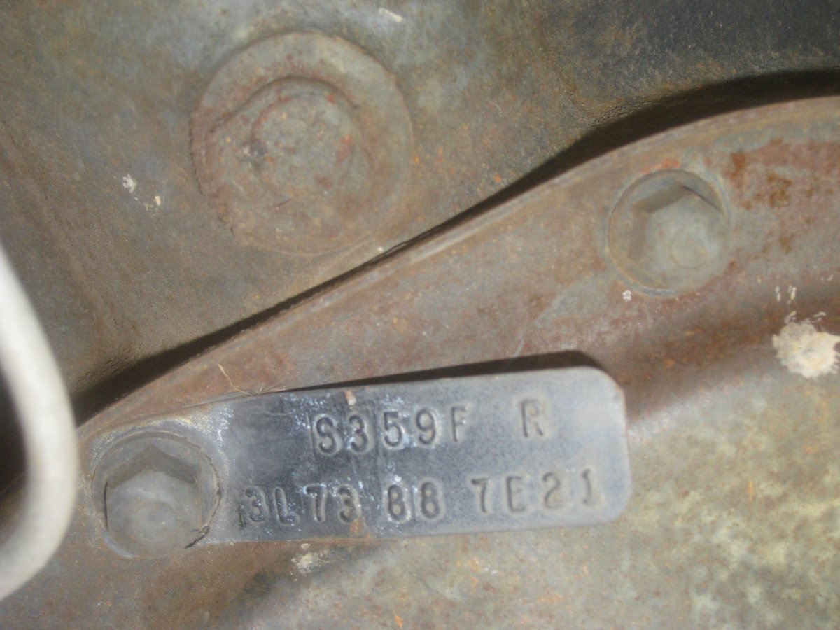

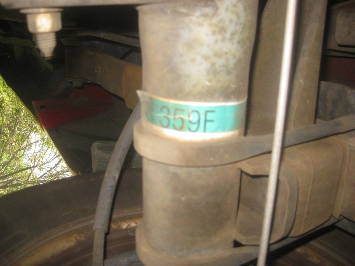

Are you sure you have a limited slip and not an open diff?
Oasis says R6 axle code that should be 3.73 LSD. As it left factory anyway. Here's tags.

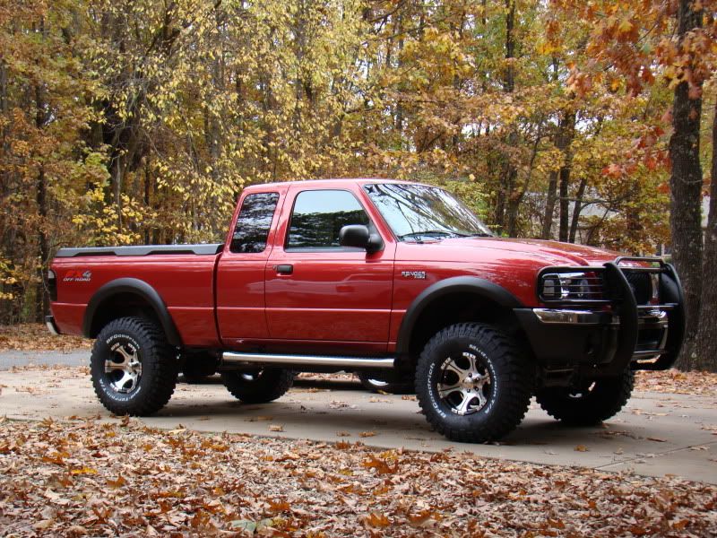

Last pic is probably closer to where I'm going it looks like probably some lift and bigger tires. I look at a ton of mod'd Rangers some don't look right. I think if it's done right it'll look right.
