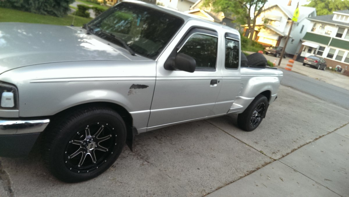

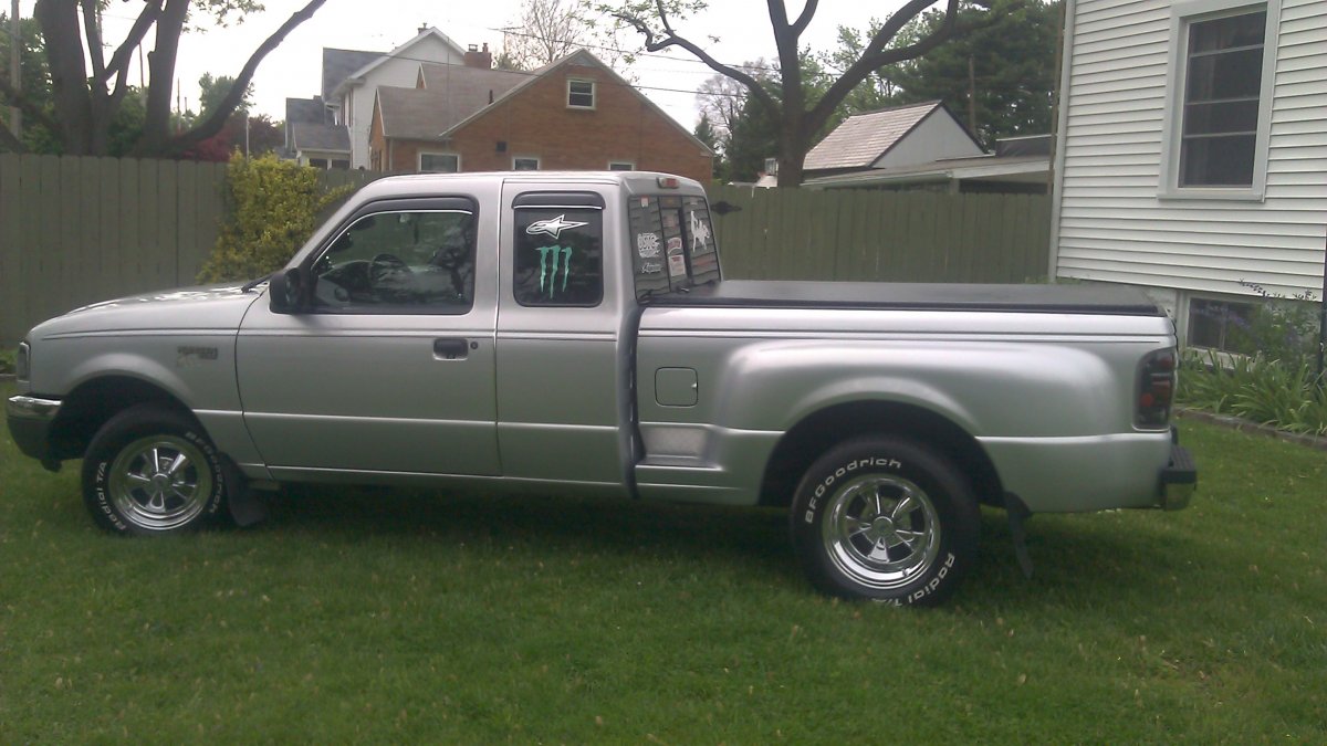

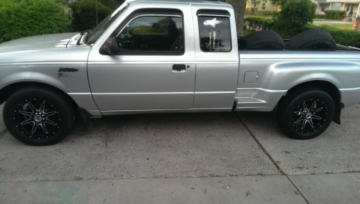

I have two completely different sets that I switch back and fourth with when I want to change the look of the truck.
Dare I say that the Cragar SS wheels have OEM 235/60r15's mounted to them?...the other tires/wheels are a larger diameter which begs the question....what are you doing to keep the speedo in sync all the time?
The rears are 295's
I believe you are correct on the front size.
Because the v6 ranger took a signal from the transmission and sent it to the PCM for the speedometer, I got a BCM out of a 2wd stick shift ranger. That took the ABS signal from the rear end, converts it to a VSS signal to operate the speedometer and sends the signal to the PCM.
My speedometer isnt correct. I would need a Ford scanner to reprogram the BCM.
