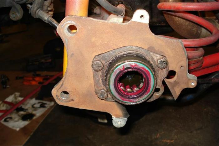

Based on pictures of the kit on SSBC website, it looks like they just packaged the mustang rear disc conversion. If that is correct, this might help:
So would I have to use the driver's side flipped over on the passenger side and vise versa
I have no idea. I've never used the kit you are talking about or done the Mustang brake swap. The components look similar, so I was hoping those pictures might be able to help you make better sense out of what you were given with the kit. They aren't exactly the same though. For one I highly doubt that SSBC intended for you to have to cut the caliper brackets to install the kit and those pieces are shaped different.
In the link I posted, cutting and flipping the bracket is being done because it is being bolted to the inside of that axle flange. I imagine that was needed to align the caliper to the rotor using the OEM bracket. The kit you have was most likely intended to bolt to the outside of the flange and has the needed offset built into the bracket. More like the "North Racecars Bracket" section at the bottom of that page.

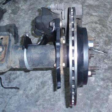

Just to clarify, when I was talking about in front or behind and inboard or outboard I was talking about the flange in this picture.
Rear drum break upgrade to disc brake
I was not talking about if the caliper should be forward or aft of the axle, relative to the truck.
