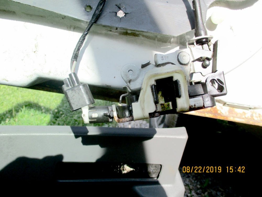

The latch itself, (Right side, lower) A is the switch connector, door ajar and dome light. B is the latch release, on mine this was stuck by dirt and rust, I sprayed with WD40 and worked it side-to-side with a pair of needle nose pliers, rinse and repeat.. C is where the cable end hooks in, it was also stuck, again, WD40 and working it up and down freed it up. D is where the cable housing hooks on. Hold C in its up position and pull the inner cable out of the slot (D) and you can fish the inner cable out of its slot.
