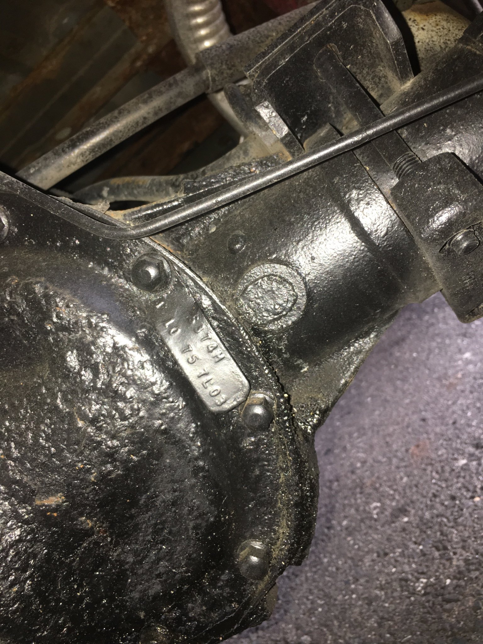

Ok guys I'm going to change my rear diff fluid and I have a limited slip question. I can't seem to find out if I have limited slip or not. My axel code in the jamb is 86. Which checks out to be open diff. But it also says I have 3.73 gears. However the tag on my differential cover starts with 4 10. I've included a pic. Please someone enlighten me.
Although it's not overly common unless the previous owner was into modifying vehicles, it may have been an axle swap for different gears, you can check the numbers on the ring gear when you have it open to drain the oil. If the tag reads 4 10, it should be an open 4.10 gear. If it reads 4L10, then it should be limited slip. Of more concern would be the question "did they change the front axle gears to match?"
Sent from my kite using a trebuchet
sorry having trouble loading pics....i have a 2x4 so no need to worry about the front...my main concern was weather of not i needed to add a L/s addictive when changing the oil, so theres no "L" on the tag and the axel code reads 86 so i guess it should be an open diff either way
To be certain that a previous owner did not install a Track-Loc, jack up one wheel with the transmission in neutral. If you can spin the wheel by hand it is an open differential or it is a worn limited slip.
Take the lazy way out. Assume that you might have a factory wet clutch pack LSD and just buy the gear oil rated for clutch type rear ends. It is penny more expensive and works in regular types also.
That tag says it's open.
Die.Fledermaus's advice is actually pretty sound. It won't hurt anything and isn't that much more expensive.
