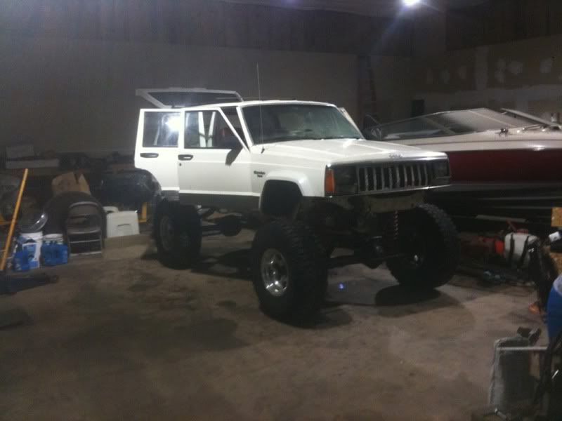

Man there is just a Colossal amount of trash talk about the D30's!!!
To be honest it's a great axle for an sas! I'm an xj owner myself but that "boat anchor" some of you guys talk about has much less constant moving parts than the D35 making it far superior as far as maintance and reliability! Hell I ran 37" Goodyear MT/R's on a D30 and never once broke a shaft. It's all about how one drives. But I will say that the D35 is about equal to the 7.5. They make all sorts of gear ratios for the D30 that you can get to match your stock rear
oh and for all the ones laugh about the D30
