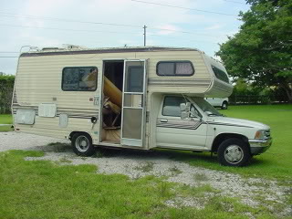

I’d look for an 80’s Toyota dually camper. That axle should be about the right width.

The issue with the Toyota - the rims are small and narrow - 14 x 5j; the backspacing was for 185R14 (aka 185/80R14) tires. Anything larger than 195/75R14* and the tire sidewalls start rubbing against each other, and that is setup for blow out of both tires.

uhaul used those toyotas on their small box trucks too, back in the day. they show up on craigslist pretty regularly here, once or twice a year.
i looked at them a few times thinking they would be cool for a work truck if i found one with the 6 cylinder, not hte 22r. my parent's toyota rv, like the one pictured above, had the 22r and you were maxed out on the hghway at around 60mph
Yeah, the 22R was fine in a Celica but asking it to move an RV is asking too much, even a compact RV.
