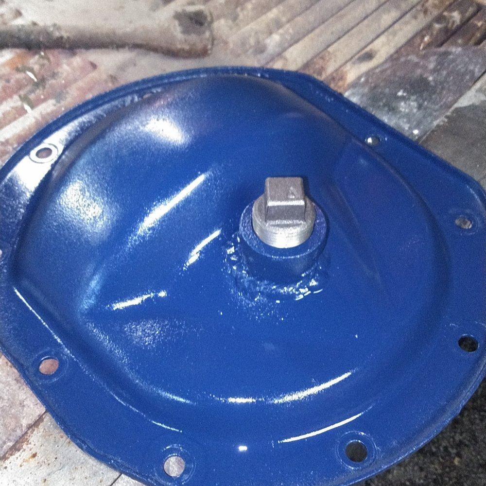

The only 7.5 diff covers that I'm aware of with fill and drain plugs ARE the "super duper" (girdle-style) covers, Grumpaw. .
But.......if you don't need the added strength of a girdle-cover, I'm sure you don't need to be told that there's already a fill hole at the front of the pumpkin casting AND that it wouldn't be very difficult to drill and tap the bottom of said casting for, say, a 1/4 - 3/8 pipe plug. .

Yup, familiar with the pumpkin filler, and did think about adding a plug.
Just looking for a used one for now...have several things/plans for winter in the garage and thought about this.
Yup, most all the aftermarket are girdle style, but some are more "stout" than others.
I've added plugs to my stock cover.
