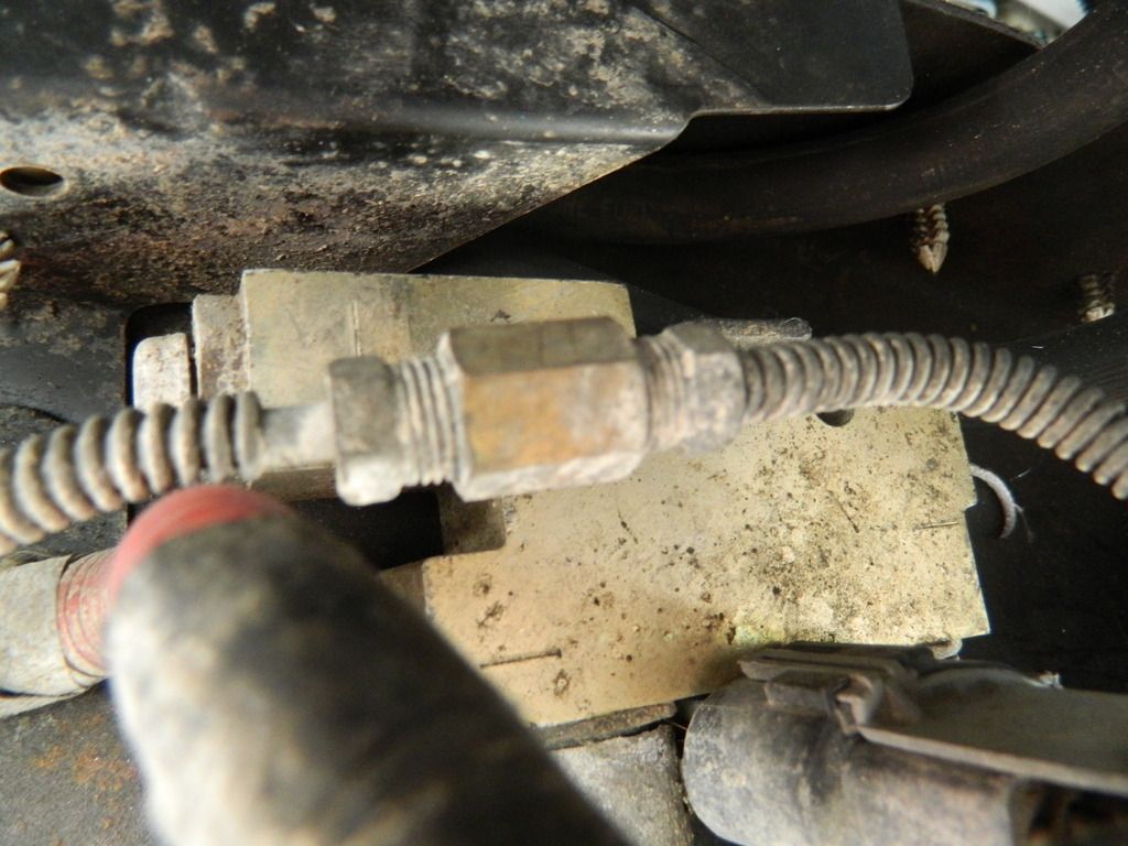

Going on 2 and a half years with my RABS "delete". I just used a male to male coupler and bypassed the pump. Mine was rusted solid and the rear brakes didn't work, and like you, I didn't want to spend $100+ on a part for my $1000 truck. Haven't missed the RABS at all. Here is how my set up is done. I left the pump on and wired so I don't throw dash lights.
thats exactly what i did

What size coupler is that? I've tried a coupe and haven't found it yet. I just replaced front calipers and flex lines and now its turned into no pedal pressure and no brake fluid to the rear brakes after I bled them. Thought maybe the RABS is stuck. No leaks in the system. Need help.
You lost me....how can you bleed the brakes if you don't have fluid coming to them?
