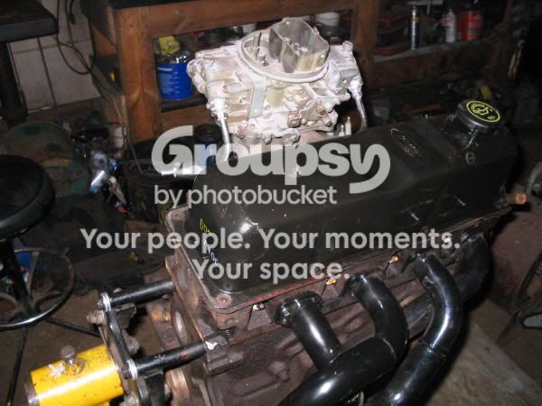

The motor all redone ready to go in.
The motor in the car, '77 pinto, I plan to drag race the car and post results and the mods that got it there. The car in race trim will weigh in about 2000 lbs.
The car is on hold as I don't have a heated garage. In the spring the motor has to come back out and a lot of body and chassis work needs to be done.
There is a 350 holley on it in the pics. I also have a 390 that just looks huge.
I haven't run it on the 4bbl yet but, it runs impressive on the 2bbl.

The 390, once tuned, will work well, it is just about the perfect size for that motor.
Good luck on finding a FMS valve cover.
Solid motor mounts, ouch.
Ouch is right. That is an open header as well! It almost brings tears to your eyes just firing up the engine while setting inside.
When it is Race ready it will have exhaust all the way out the back.
When the junkyard sold I had to grab everything I could and find a place to put it. I lost a lot of good stuff. The Pinto motor mounts were in a Van that got crushed. I contemplated grafting in Ranger mounts but, then decided against it.
When the motor progresses it will need better than stock mounts so I went ahead and made solid mounts.
