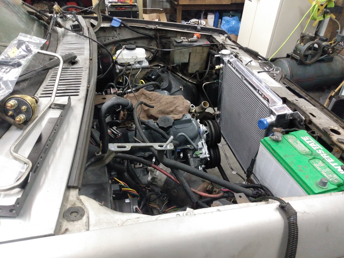

I've got a Champion for my 88 auto I removed AC. Fits nicely. Trans lines hook right up. I added an upgraded 6 row trans cooler as well. Here is the radiator. Not sure of cooling capabilities at this time, I ordered the 16" fan with it but haven't gotten truck all back together yet.
