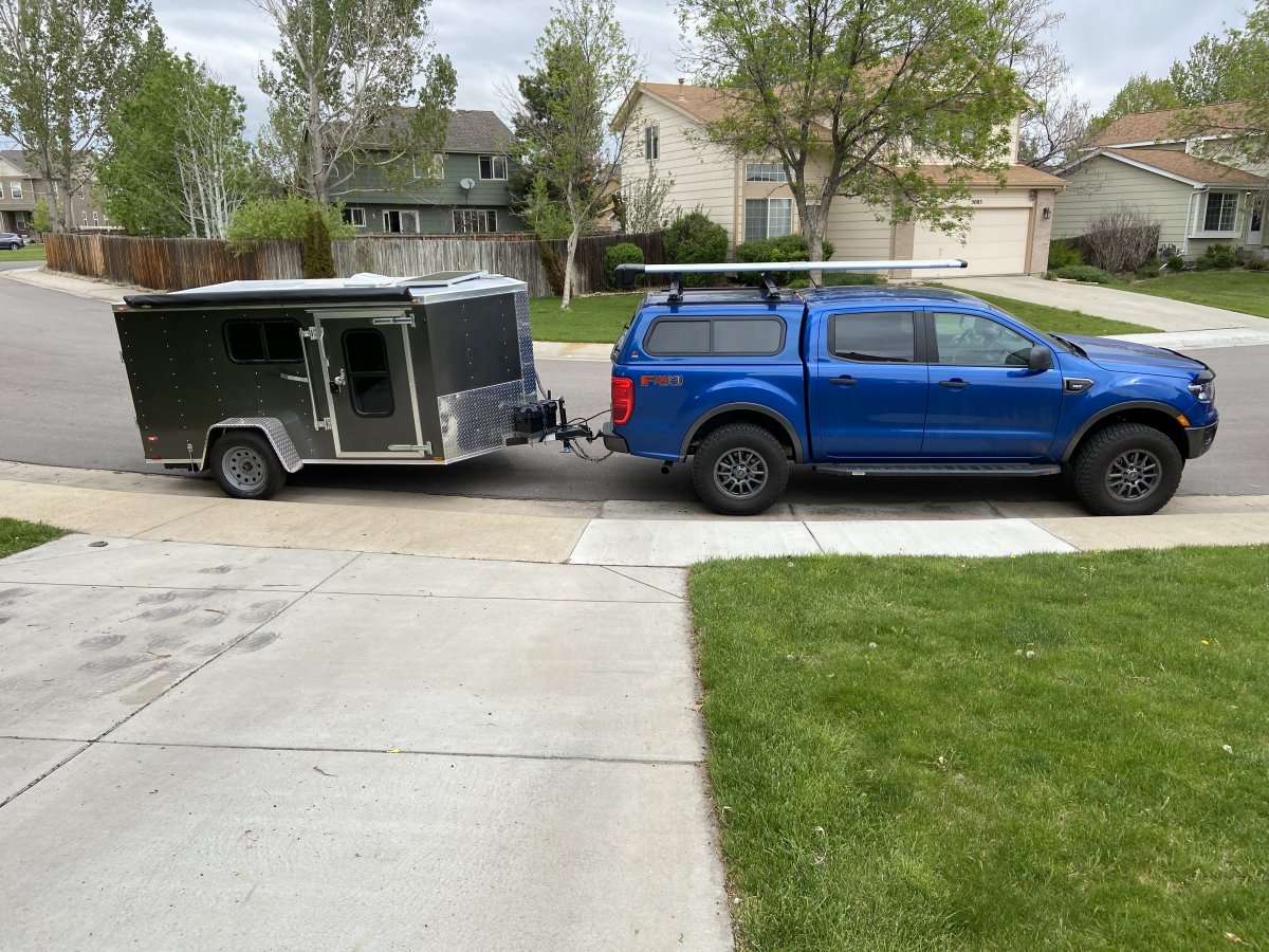

In my 2020 we hit some mild trails. Maybe 16 miles of dirt track with some rocky areas here and there.
with the fox 2.0 suspension it handled everything really really great. Used 4hi most of the time, tried out 4low a little. Neither were really necessary though.
Now I have a rattling that sounds like it’s coming from the front right. After 30mph it stops. I can’t see anything loose. Poked around and tapped some parts and everything seems in place. Drives normally too. Any ideas??
