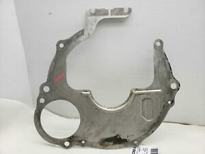

I had a rattle between 2500 and 3000 RPMs. Swore it was lifters. Turned out I was missing a bolt on the thin metal backing plate between the tranny and engine.
Is this plate visible from underneath? Easily inspected?
Yep, look between the engine and tranny by the starter. It was missing one of the bottom bolts. Its a long shot you have the same trouble, but worth a look. The plate looks like this:

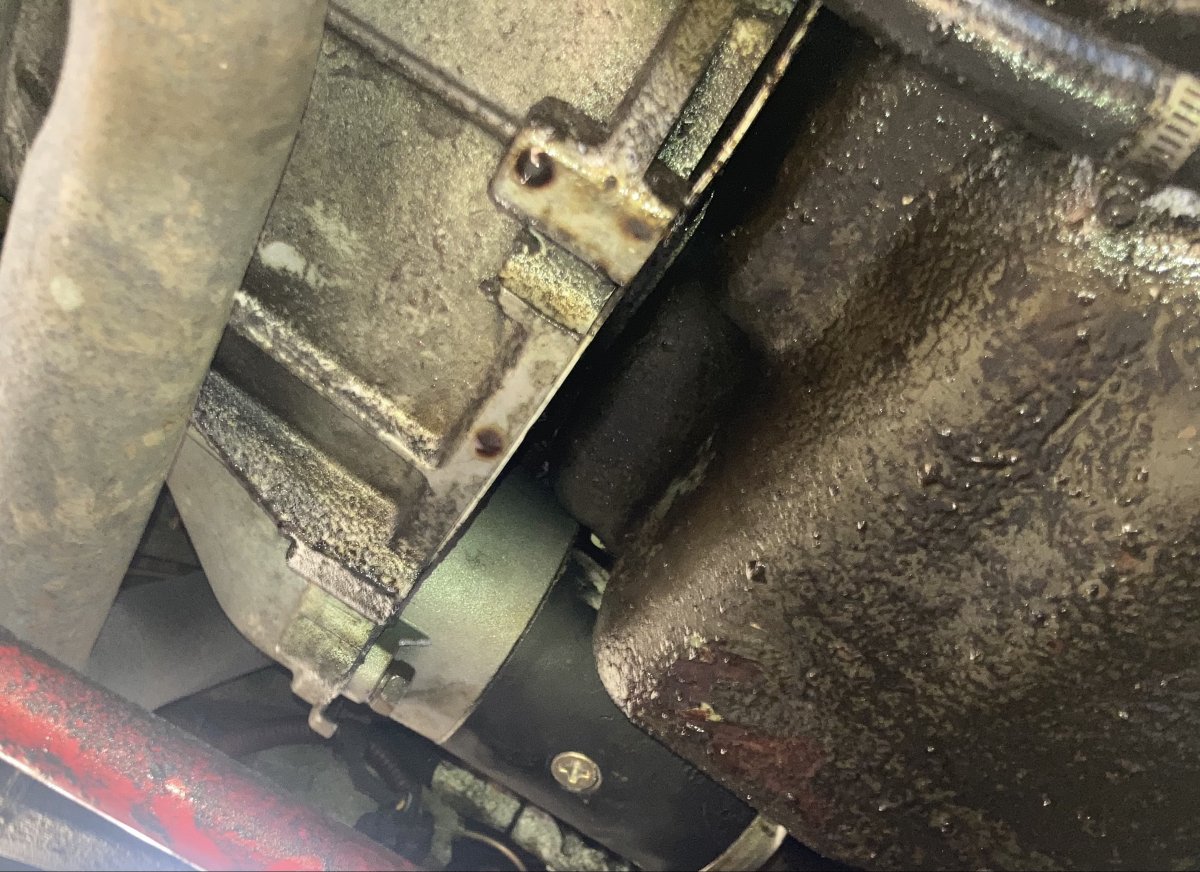

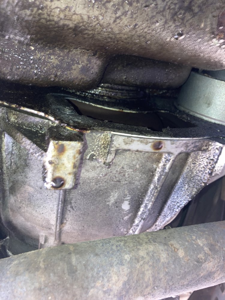

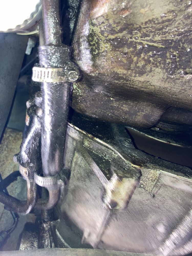

So i've finally inspected this spot and found that the thin flexible plate does seem to separate around 1/8" for a whole lower section. Pics below. First one clearly shows the gap.
I'm confused what the purpose of the thin plate is though, at least in this section of it. I thought i had discovered a wide open problem but in fact i saw that there's already a huge curve shaped gap in the thin plate piece just above it (shown in other pics), so it can't possibly be sealing something right there. Or is it?
My plate doesn't appear to have the same shape as the one pictured by ECGREEN. Mine has that curved gap.
It's tough to tell if screws are missing and this is a problem, or if the plate is just sorta old and bent but this has no impact on anything.
I've recently started noticing kind of a fuzzing / spitting sound from underneath in this area but that could be because i've quieted so much other clammer in recent months. Maybe this loose thin plate is simply vibrating causing the spitty sound, or maybe they have nothing to do with each other.

I believe we are addressing the proverbial "dust" cover. Yours was out of shape when installed and left uncorrected. It is not a sealed surface, just keeping out unwanted stuff.
