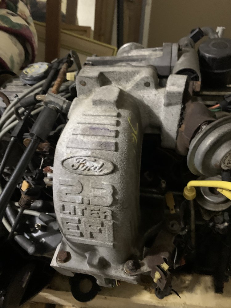

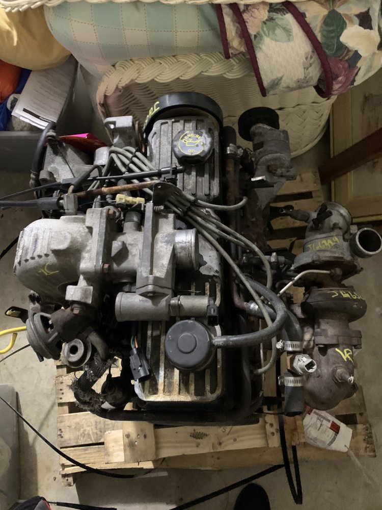

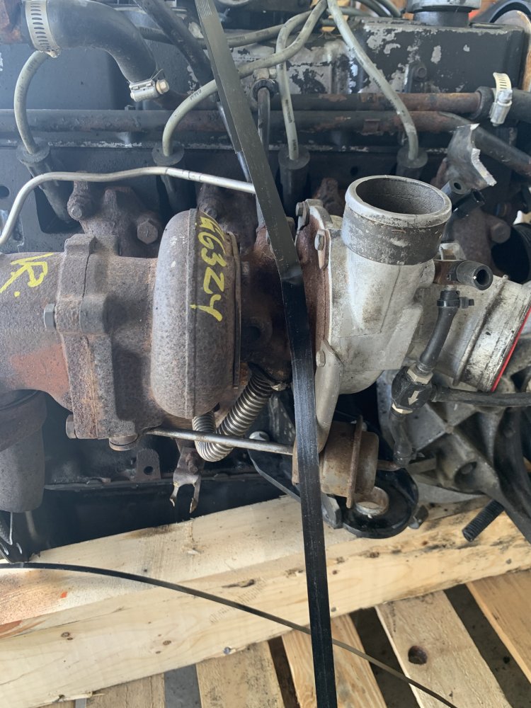

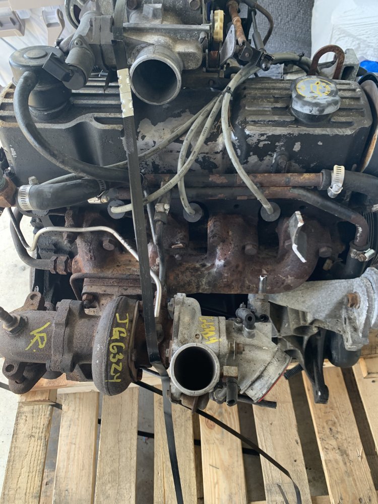

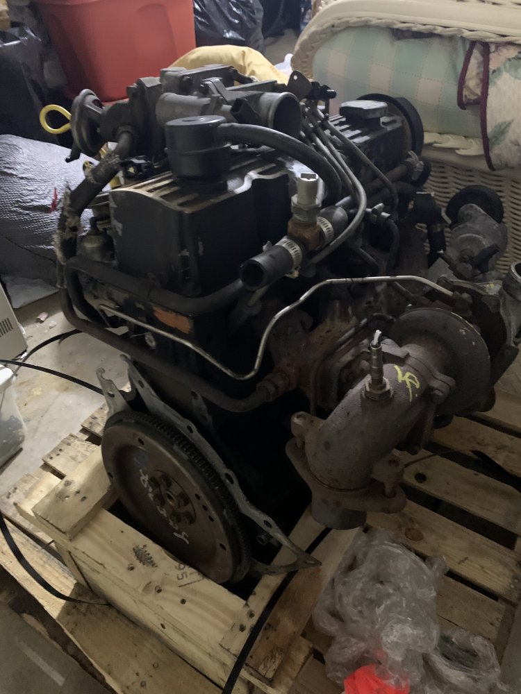

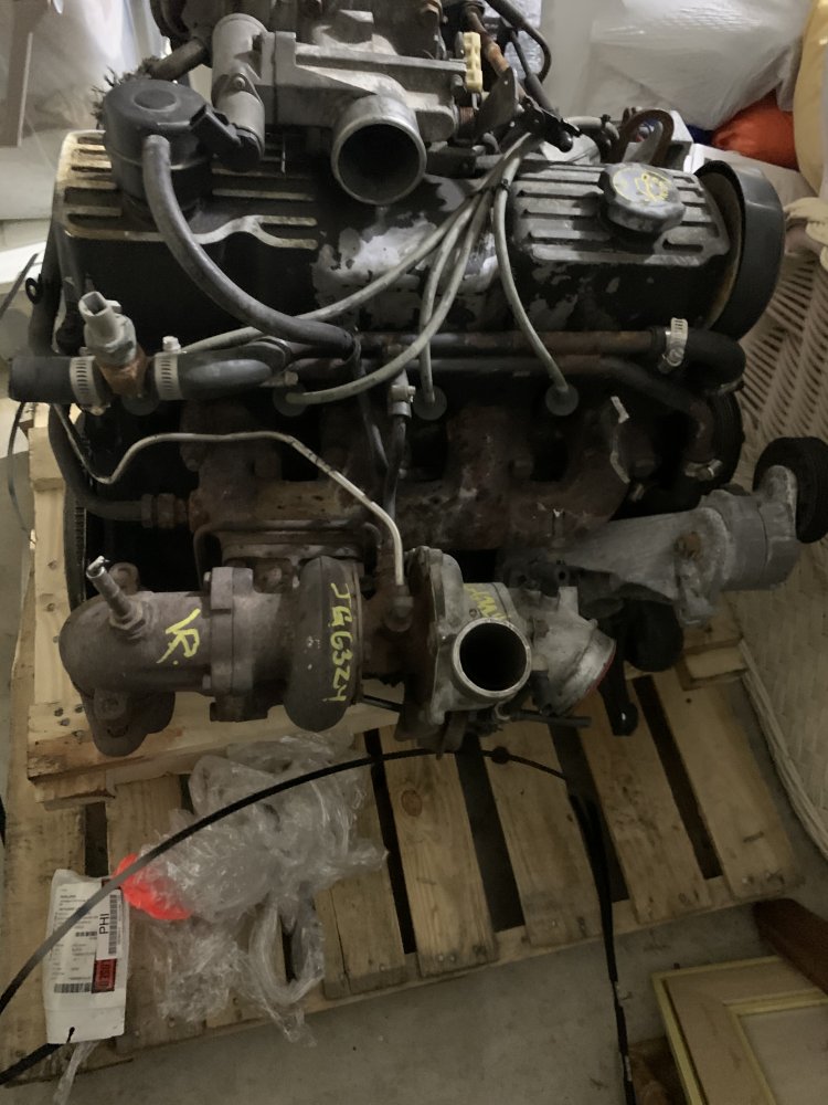

Hey thanks! It’s nice to finally get a reply around here! Here’s some pictures of the engine:

Based on what I’ve read, it seemed as though the 87-88 TBird swap was the best way to go in terms of “level of difficulty”, performance, reliability and cost. If I remember correctly, I read that the block has factory forged pistons and a better flowing head with a larger combustion chamber. This particular engine that I have is apparently from an 87-88 Ford Thunderbird with only 114,000 miles. I was able to purchase the engine for $575 shipped. This seemed like a really good deal to me being that I could not find this engine locally and the only other options online were almost 3-4 times the price. I do plan to change all gaskets/seals. I’m really leaning toward upgrading the turbocharger. Should I replace engine bearings? As far as engine management goes, what’s the next cheapest route I can take being that I do not have the original ecu for this engine? Thanks!

Hello RXLT...want fries w/ that? I'm sure you researched the Explorer rear diff. swap; all the measurements, you know! Also, my '92 Ranger has serp. accessory drive. Various yrs. should work on your engine. D.O.D...Dumb question Of the Day, so far...your trbo looks smaller than my Garrett T3. Is it a Borg IHI? If it's an IHI, would you be so kind to measure the overall length. I'm hoping it's shorter than the T3. My swap is stalled because of turbo exhaust flange clearance @ the evaporator housing. No 'flip chips' & No steel "headers" here. If you're going for more power & you have an IHI, I may be up for a SWAP with my bigger Garrett T3! Does your '97 FRXLT have the evap. core in the engine bay or inside the dash somewhere? Did you get the computer, wiring etc. w/ your engine? I may not need mine. I plan on using my OE computer & installing COP (coil on plug) ignition by removing the 2 FORD coils and bracket (for room) and hard wiring the coils right into the Ignition Control Module (ICM.) The 'normal' HP produced by the turbo will be plenty enough for me. I'm a plug 'n play, set it 'n forget it type. Thanks, watteran.

Thanks for your reply! I do believe it’s a Borg IHI turbo and sure I’ll measure and post as soon as I get some time. As far as power goals, the plan was to just complete the necessary maintenance and get it swapped in. I was hoping to make around 250-300whp on the stock block for now. However, I could not find much information on what my ECU options are. All I could find was that I need the stock computer/harness (which I don’t have) or standalone ecu. So after having to purchase a standalone ecu and possibly a Ron Francis wiring harness, I’m thinking of whether or not I should go for more power. To be honest this is all new to me. I’m a Honda guy so I’m still trying to learn all I can. However, there’s not a whole lot of information on this swap from what I can see. I really want to get this done the best way possible and I’d being lying if I said I didn’t feel a bit lost. Any and all help would be greatly appreciated. Thanks!
