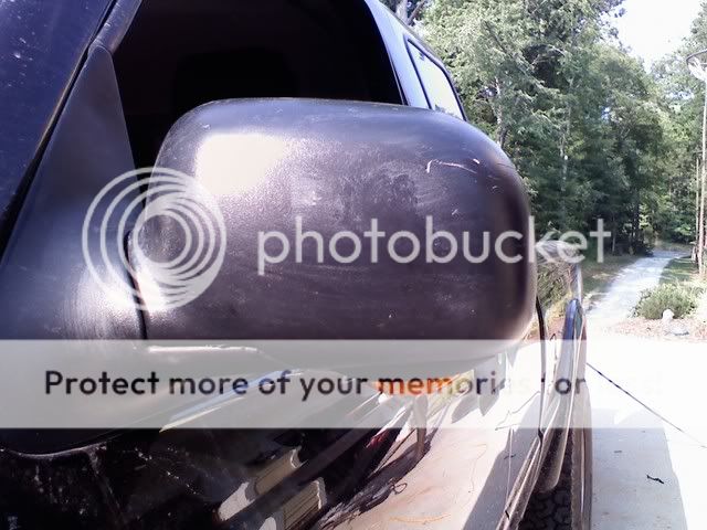

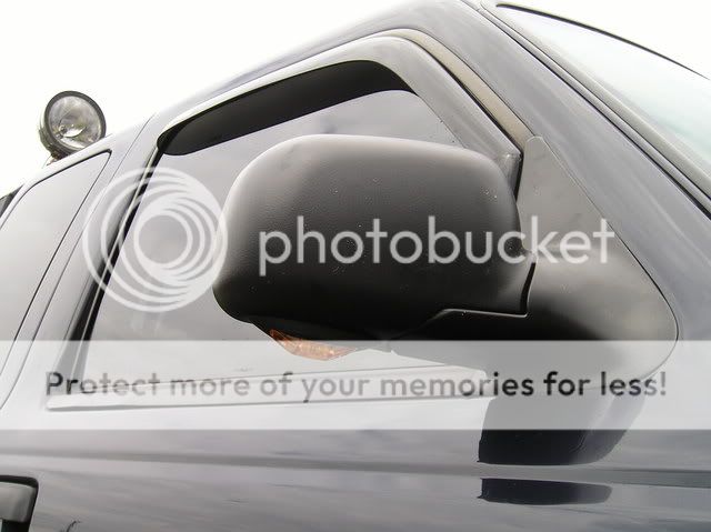

If he's putting them on the outside of the mirrors like the 08+ Super Duties they shouldn't affect visibility at all.
I don't know what you have access to down there RSH but I got a set of "Kool-Vue" 06+ style mirrors for my truck. They are less expensive than the Ford ones and look every bit as good.
yeah i will get some aftermarket 06+ power mirrors
i can get them for 73USD the pair. not too bad i guess.
im planning to mout them this way
