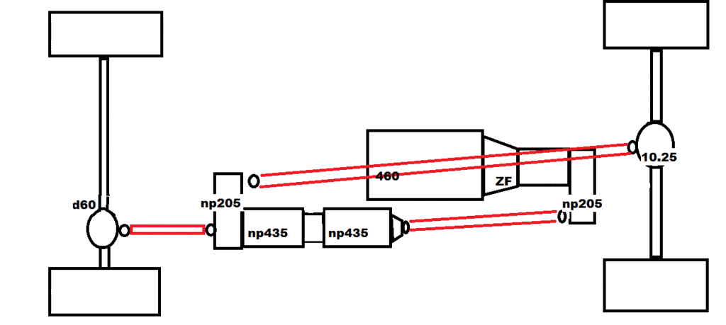

i figured the easiest way to explain the drivetrain on this thing was to draw a simple schematic...so this is it.front is to the left.
