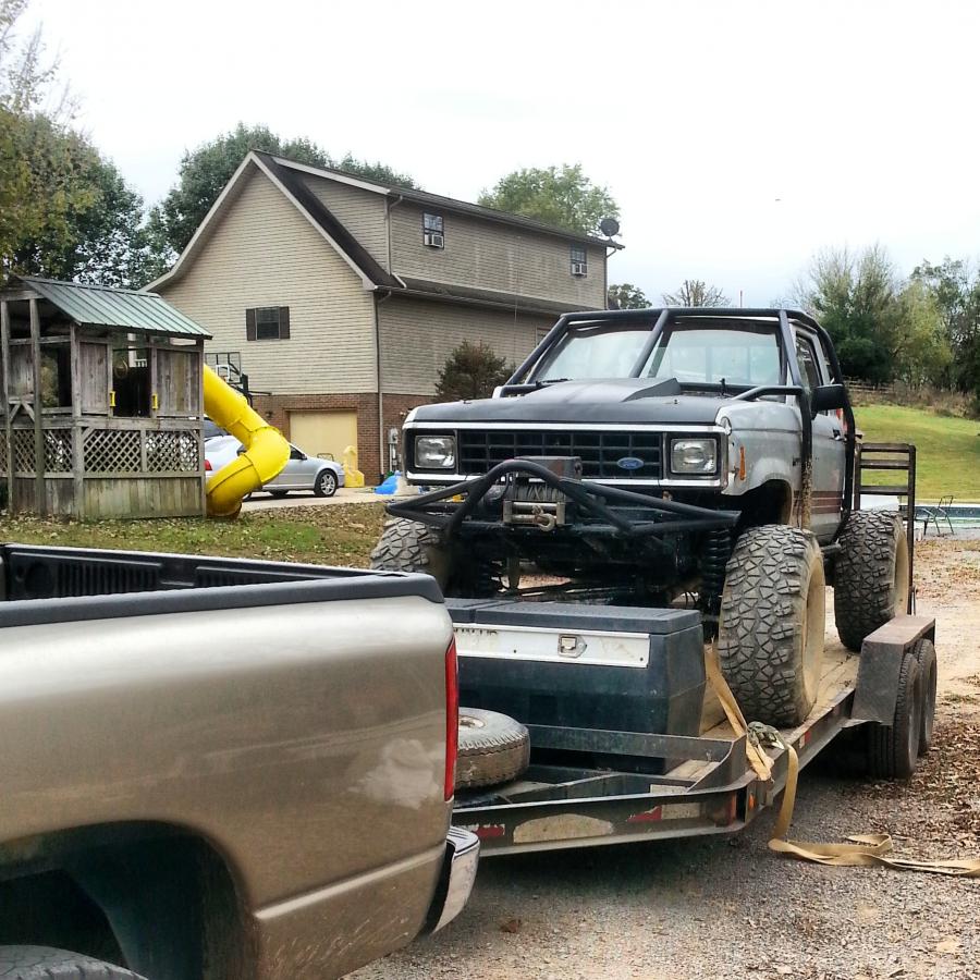

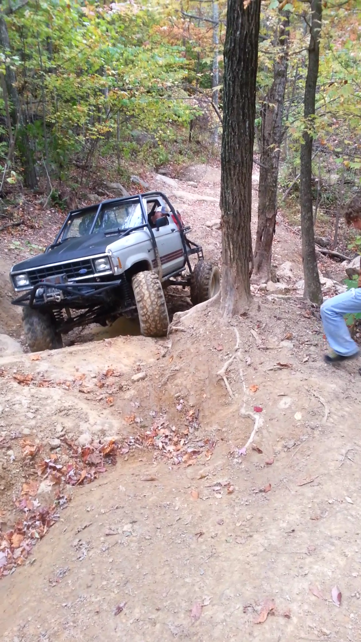

Looking sweet!! Any more info on the build?

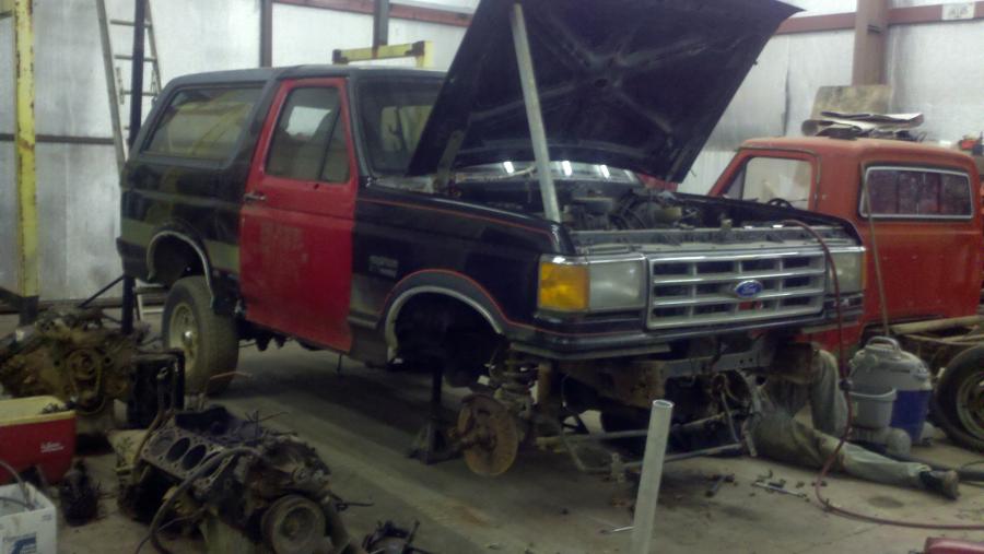

Thanks man! It started life as a 90 bronco. Solid axle swapped with custom radius arms with johhny joints with deaver coil springs and james duff shocks and the front is stretched. Swapped the old rear end out and moved the leaf springs back. Swapped the ranger cab on and wired the bronco efi 5.0 with the ranger cab. Relocted the batteries and gas tank. Custom radiator support. Has a dana 44 with 4.88 gear and welded. Rear is a 9 inch with a 4.88 and full spool with disk brakes. Custom exo-cage. Custom drive shafts. Hopefully soon 4 link and coil spings in the rear! All of it was done at my house.
