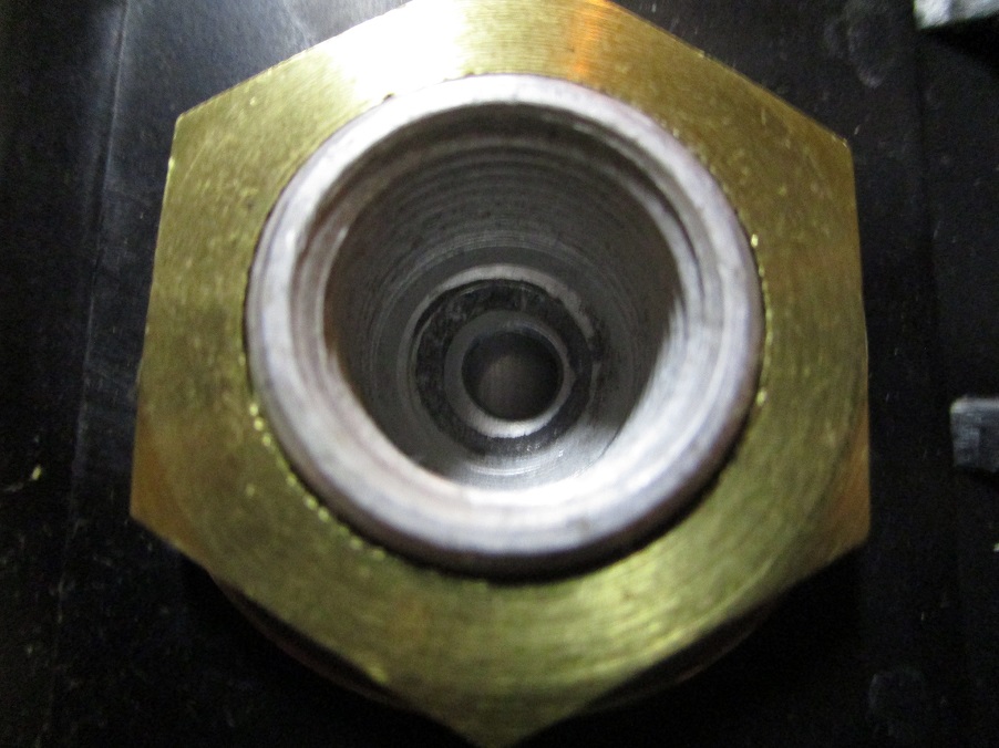

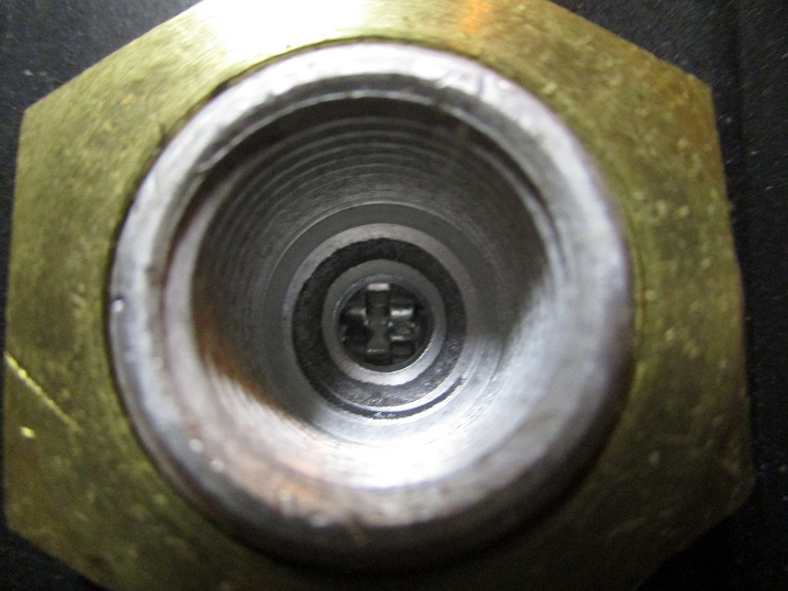

please reply soon because my truck is all taken apart and I'm not sure if I should install this new radiator or buy one from autozone.
I bought this radiator off ebay for like $80, more than half the price of autozone,
but where the trans fluid lines attach, the upper one has some sort of honeycomb filter (now that I'm writing this, maybe it's a beneficial filter?) and the bottom line isn't blocked totally but basically there's a plate or something that only allows about 1/8" space for the fluid to enter.
As shown, the OEM radiator has neither of these.
Should I install this?
2008 ranger 2WD 6 cyl 3.0 Liter.

can you blow thru it? poor fluid thru it?
It is probably just a restrictor on the inlet or outlet (don't remember which is top and which is bottom...) to slow the fluid down through the cooler to help it work maybe? Some radiators are a double wall tube and others are a coil of tubing, I think stock is the coil, the double wall tube is probably less flow resistant so maybe they slowed it down?
someone suggested see if I can pout distilled water in them, and it does flow in, i installed it anyway because need truck to work.
Some of the high end 3 layer all-aluminum ones on ebay (around $150, I got the $75 one but the $75 worked fine on my old 2000 ranger installed in about an hour no problem), second to last pic you can almost see what looks like the same honeycomb type thing in the hole.
But it doesn't matter now because now I have to run to autozone and pay $215 for theirs because these two fittings cross threaded my damn transmission lines! The first bottom one seemed to go in ok , total PITA to work in that tight area and of course the line wanted to twist with the nut when starting to remove, then the top one I noticed was cross threading, so I installed one of the two sets of adapters and it seemed to fit fine, then added a gallon of coolant and turned truck on with heater on ready to fill to top and noticed the lower transmission line was leaking bad, so now I'm just going to buy the autozone one. IDK how the preinstalled fitting would cross thread, i've installed tens/hundreds of thousands of bolts professionally etc and it seemed to be going fine but the stock fitting cross threaded and the only other adapter that was even close also cross threaded.
Might see if I can take these fittings off my old radiator, if not will buy AZ radiator.
so i went to autozone at like 3am and got the Duralast Radiator C2310 for $215 and installed it and it all went smoothly as it should.
Luckily most of the stripping/cross threading happened to the female threads of the eBay radiator and not my transmission cooler lines because then I'd have to change them - they're flare nut and I don't have that tool and I don't think AZ rents that, and there might not be any slack if I cut them back for a new flare, and AZ doesn't even carry this part and the kit of them is like $150.
The female threads on the Duralast Radiator fit like a glove as they should I was even able to hand tighten them most of the way, there was definitely something up with the threading on the eBay radiator but they sell hundreds of these no problems.
I was thinking because the 3.0 6 cylinder is quite rare vs the 4.0, some parts aren't compatible (like the alternator I paid like 3X price for because the common one doesn't fit), so I was thinking maybe the 3.0 actually has different flare nut threading than the 4.0 and that the eBay sellers just assumed this radiator fits the 3.0.
But it turns out, on AZ's site if I change the truck to the 4.0 it still shows the Duralast Radiator C2310 as being compatible for both, so I'm baffled.
