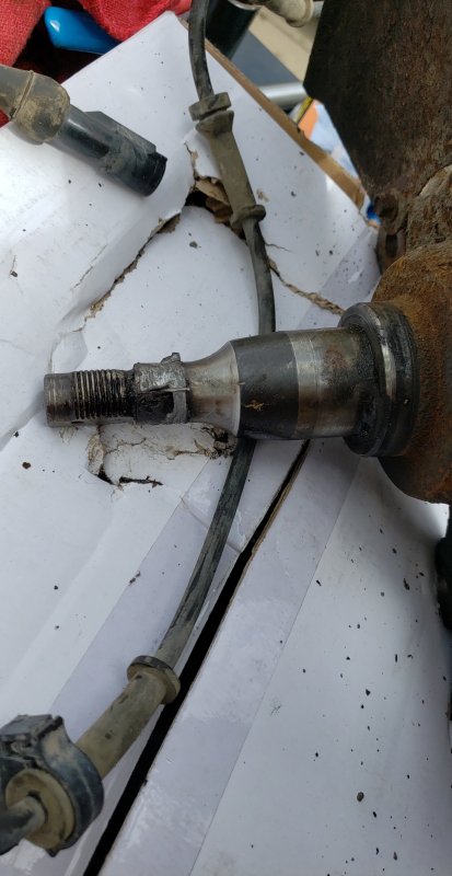

Got it home, wanted to inspect the tire, bearing, and brakes since suspension was good and the howling was connected to a rotational part somehow. I put the RF up on the jack, grabbed the tire, and had about 1/4" of play in the tire. Ordered new seals and bearings, got them, started work. That outer bearing and washer are welded in there at this point. I am trying everything I can to free them up, no use. Heat, hammer, more heat, nothing. I'm afraid I will have to get the air hammer and grinder out soon. Either way I will start working on it again (I gave up that night when I couldn't get the bearing out) tomorrow morning, so you'll all have an update then.
