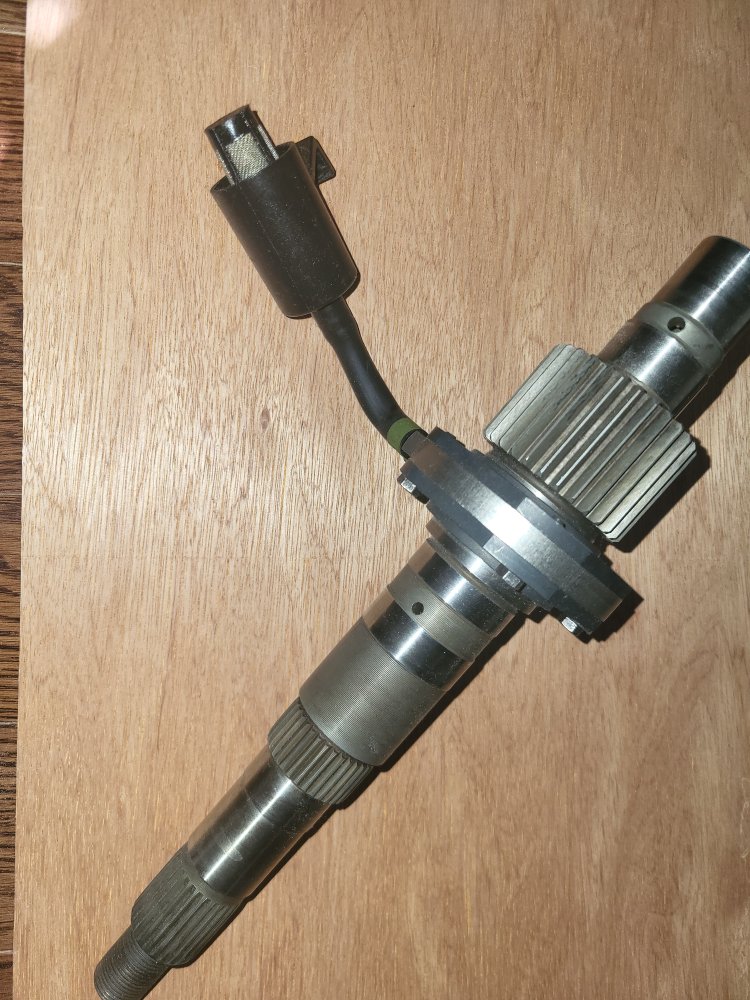

When driving the truck in 2wd (and 4wd), the output shaft is driving the oil pump in the transfer case. If the rear output shaft isn't turning, the pump isn't turning so there is no oil being supplied to the gear sprocket on the rear output shaft. With the transmission in park/gear the rear output shaft isn't turning.
Picture being worth 1k words:
1st picture is output shaft with pump attached. You will note the 2 cross holes (between the shiny bearing surfaces) where the oil from the pump comes out for the low ranger gears (upper right) and the 4wd sprocket <I guess it technically isn't a gear> (middle of frame).​
2nd picture adds the 4wd sprocket to the mainshaft (4wd shift slider is off; its just being used to balance shaft for the picture)​
