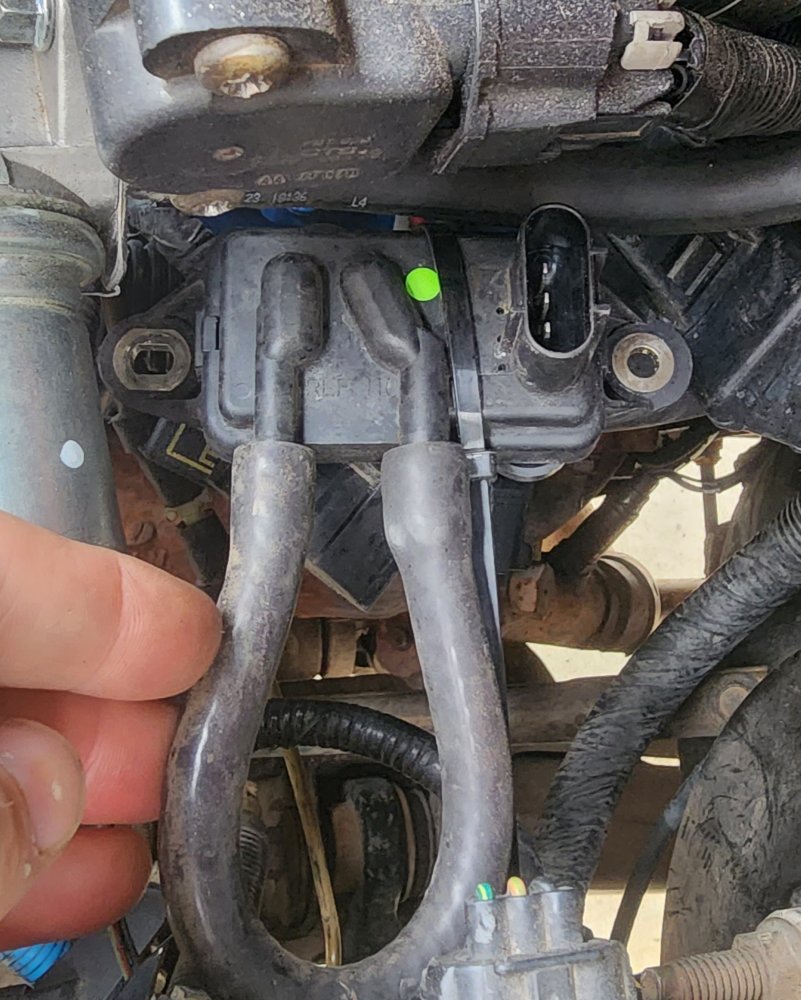

Sorry it took me so long to get these here. Just connect a piece of hose between the two ports on the DPFE sensor.

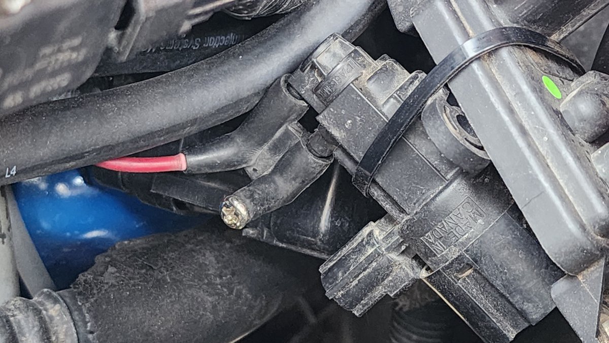

Disconnect the green vacuum line from the top of the EGR valve and pull it out of the other end that hooks up by the red vacuum line.

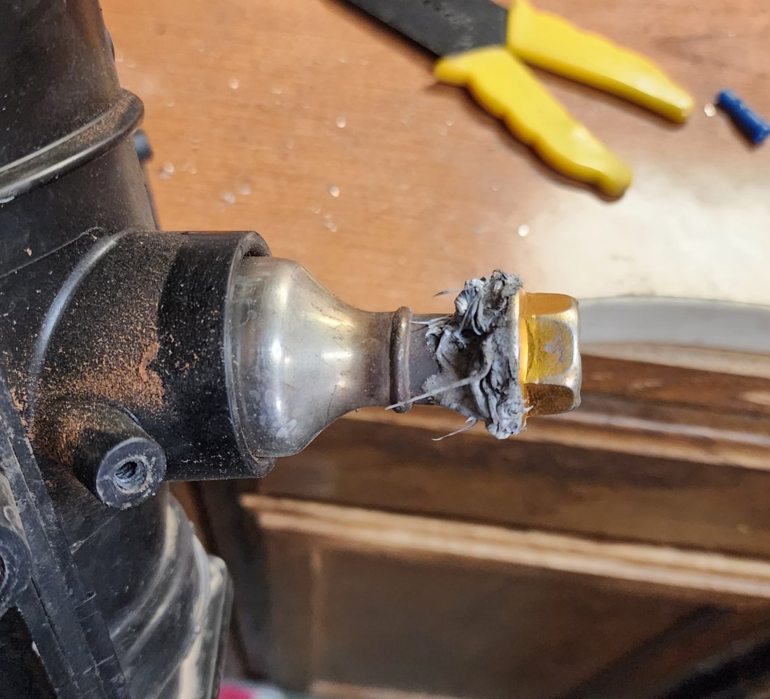

Cut the EGR tube that goes from the intake plenum to the EGR valve. I used a 1/2 bolt with some RTV to seal that.

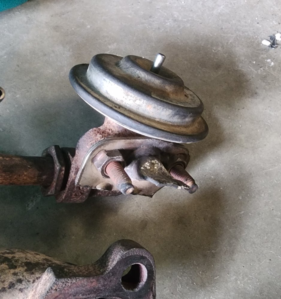

You can remove the EGR tube from the manifold altogether, or use a block off plate, or simply pinch the end of the EGR tube where it comes out of the valve.
