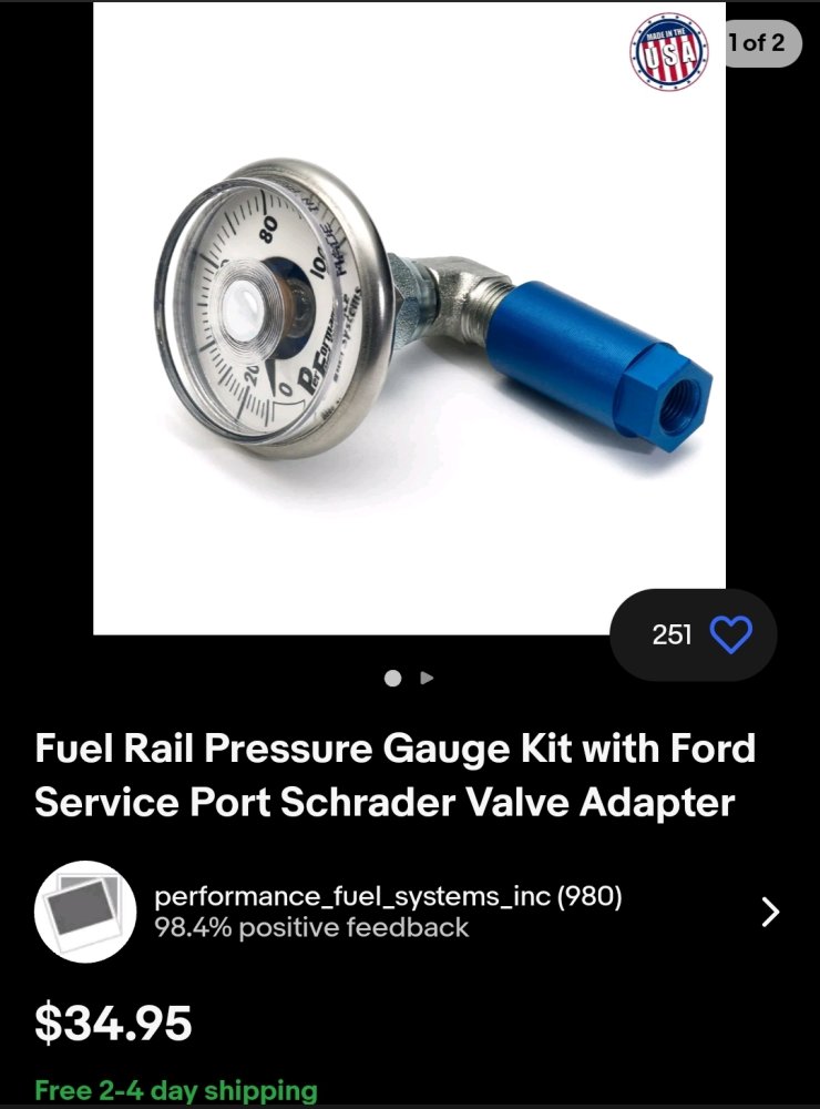

Is there a fitting for it? And can you send a link so I can get the gauge? Are these gauges all universal?
@tw205 Would this work? Or can u send me a link.
On the fuel rail there is a port that looks like a air connection to fill your tire. It’s called a schrader valve A fuel pressure gauge from the auto parts store will screw onto it. The one you showed should work splendidly.
