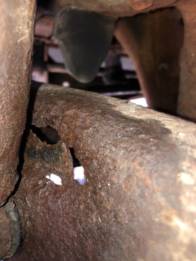

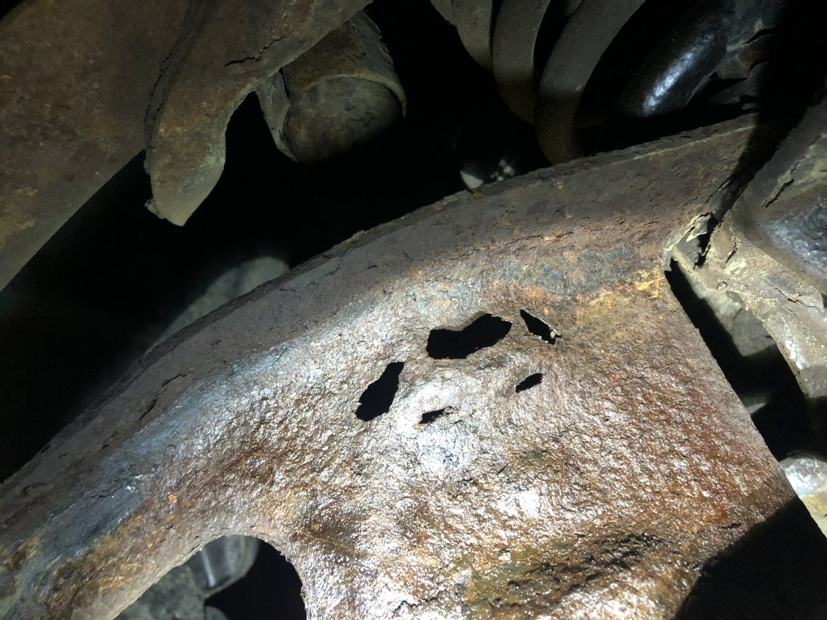

Hi new to forum I have a 97 Ford ranger 2.3 auto I just notices my drivers side radius arm has rust holes above shock mount I plan on replacing it but don’t have the money todo it right now is it ok to drive for a few weeks like it is I added some pictures
Just dont whack into any potholes, curbs, or anything else hard. I think youll be ok.
I usually like to go by the theory... if a suspension component has rot holes in it, stop driving it and replace it.

It should be replaced sooner then later....but dont drive like a loon i think youll be fine. Keep an eye on it. I doubt it would fail all at once.
When you are under there replacing that arm, take a serious look at the rest of the truck. It's unusual to have something in one place rust out without having damage and serious rust in other places.

Seriously, I agree with Rusty on this. Drive it carefully and replace as soon as possible with emphasis on "soon".

I know that pretty much every time I’ve ever looked at pics of something, then went and looked at it in person... it’s looked worse in person.
Thanks for the reply I going call shop in morning see if I can get estimated on getting it replaced rest truck is pretty solid for being in Ohio lot better then most around here other then the radius arms other one don’t have holes in but is very rusty
Looks scary, I would park it until you can replace the components.

If you have any other option at all park it until you can get that fixed.
