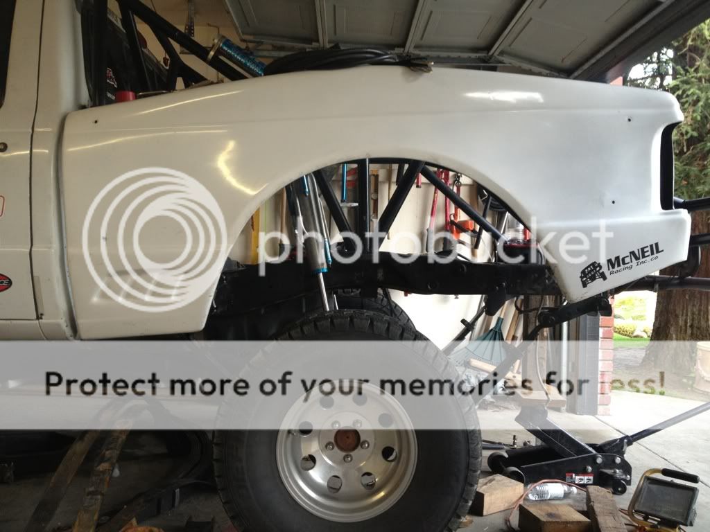

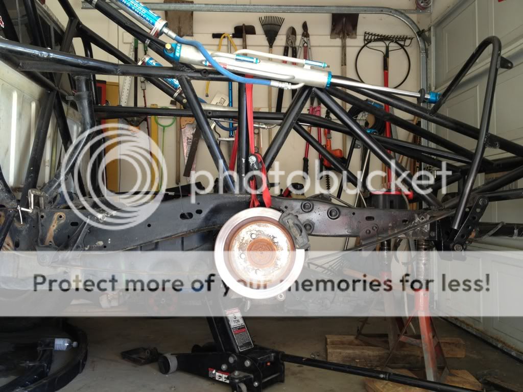

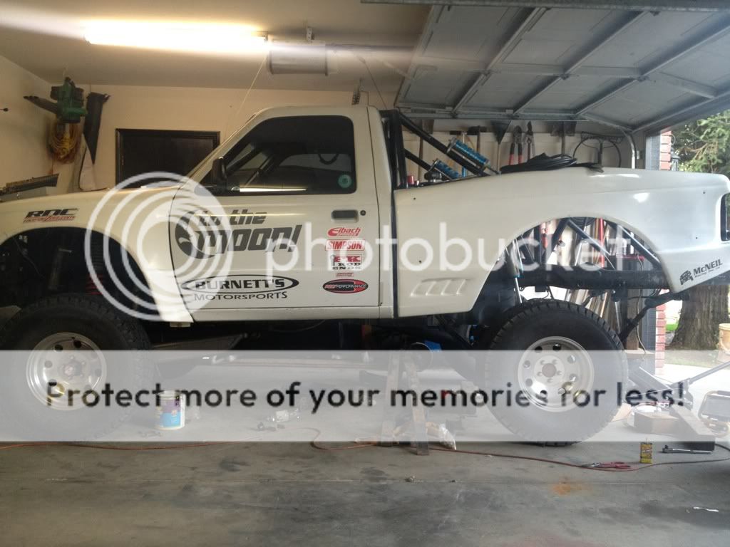

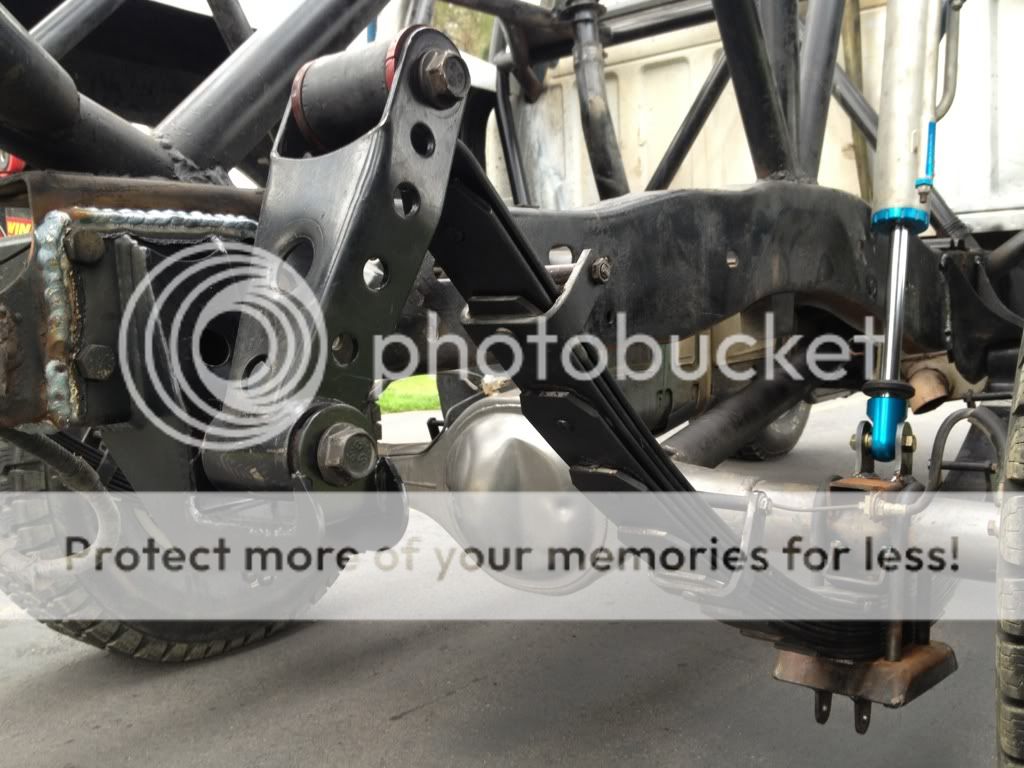

Got the new rear hangers in, moved both front and rear forward and found a good position. Pulls 18" of travel.

Lol thanks but no need for envy.
At droop the driveline is just about bottomed out into the trans, might have to shorten it a 1/2 inch. If I move the hangers back much more the housing will miss the bump pad.

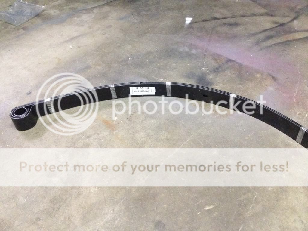

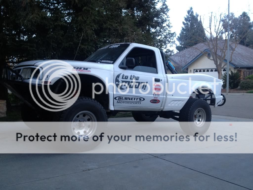

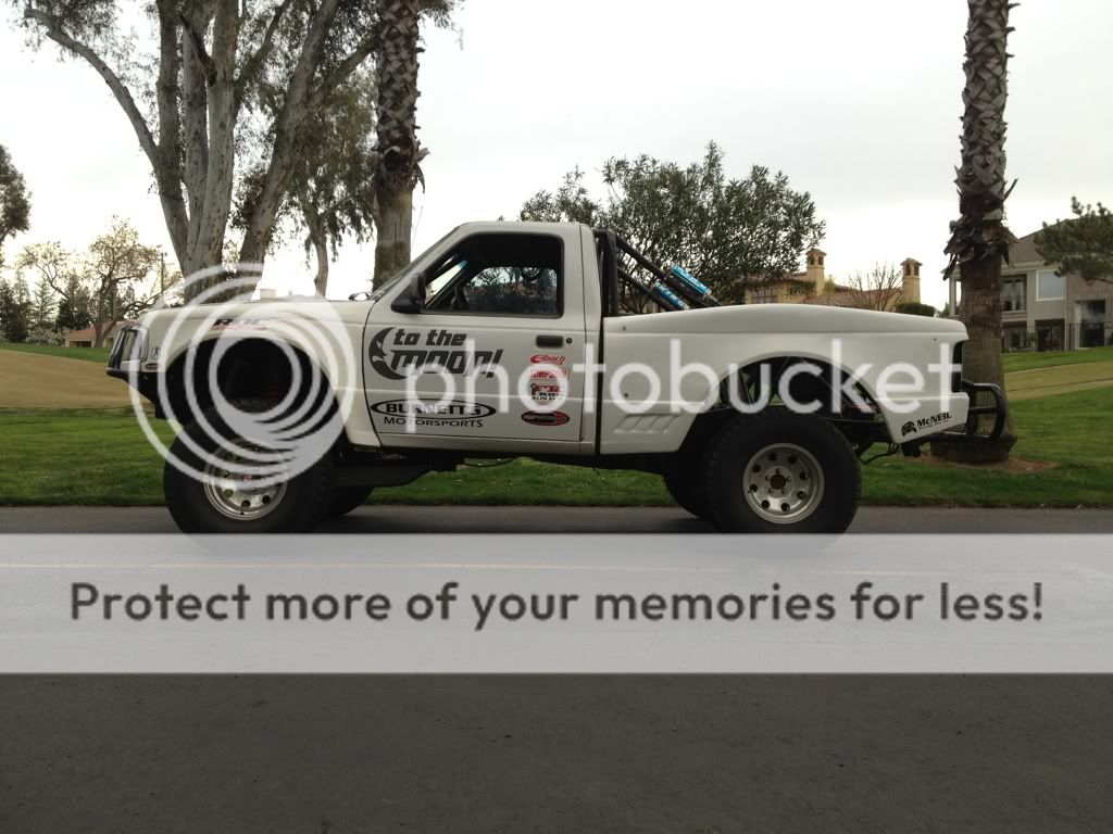

Springs finally came in to freshen up the pack so I can finish this thing.
Sits much better now.. About 2" lower.

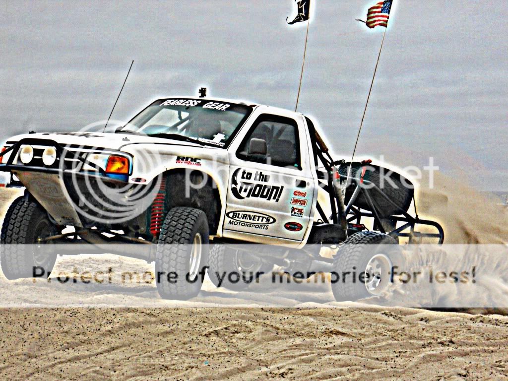

Took it for a test drive.. Send to work good, it will be in the dirt tomorrow if weather permits.

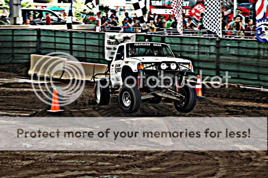

edited a few pics in class, thought I would share.
love that truck. Mine will be there someday.
