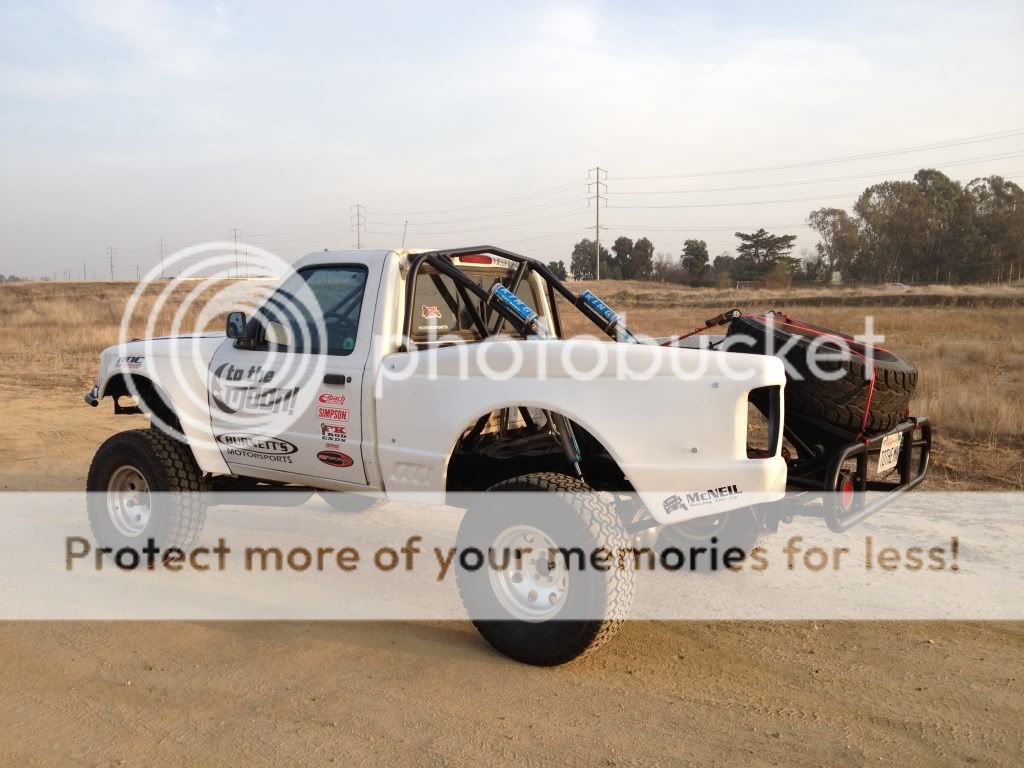

That is my truck in the article but I did not do the write up and it is kinda misleading. I since moved the rear hanger because it binds in the position shown in the article. Also I built a MUCH better 8 leaf pack shortly after still using a chevy main leaf. Simply arching a set of silverado leafs didn't work nearly as good as my new pack and they broke in half lol.
I'll find a pic of my current spring pack when I get home.
Ok so its a 5 leaf pack arched to 15" or so. It contains a mix of explorer, s-10 and chevy 1500 leafs. I have ridin in many trucks with various deaver packs and this set up works just as good or better in some cases. Untill I link the truck I will continue to run this home brew. I am currenty putting together another pack that should do better with all the weight I will be adding.

The rear end is a ford 9" with 3/8 wall tubing, custom 3rd with spool and 35 spline axles. The brakes I used explorer backing plates and calipers.
My new pack was arched together and yes I snapped a leaf in the old pack. The final position was basically back one hole then down one hole. And the tires are 33x12.5.

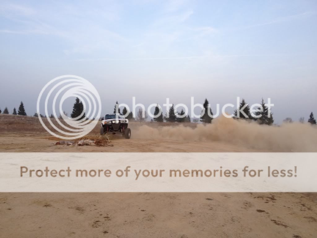

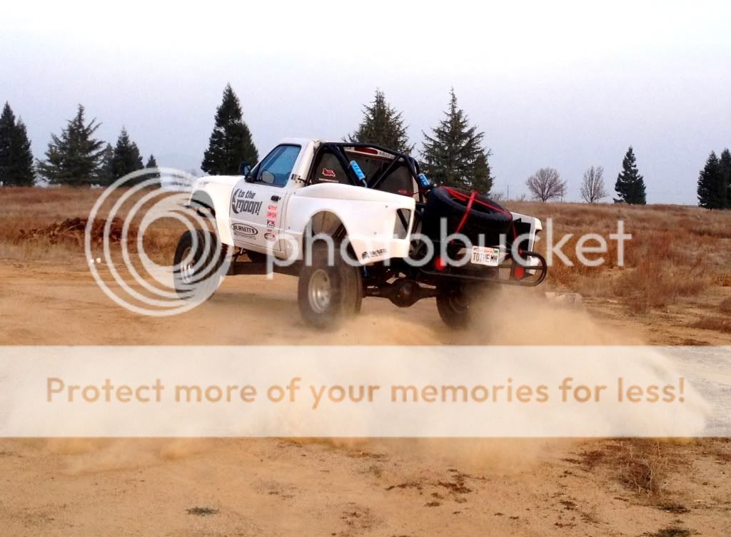

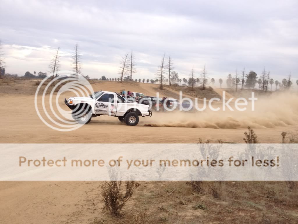

ALMOST Rolled the truck today, would have been pretty angry. But I didn't so it was fun day with a few other trucks. Got some good vids I will post later.
Drifting a berm, I caught a lip and went up on the 2 pass side tires. Turned into it and pinned it to bring it back down. Wasn't too crazy but def the closest I have come to rolling it. I think it's because I lifted the front a bit with the new springs, gotta drive it a little differently.
We did the same thing in a race.....defiantly had some seat in my cheeks
