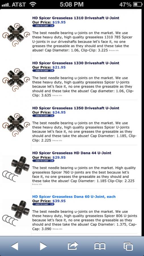

Thanks for all the help, guys. I went and got the micrometer out for accurate measurements and here's what I got... (All figures rounded up)
Flange
Cup Diameter: 1.06
Spring to Spring Distance: 3.63
Total Distance: 3.99
Shaft
Cup Diameter: 1.05
Spring to Spring Distance: 3.59
Total Distance: 3.87

That is correct for a 1310 series u-joint. The slight variance in your measurements isn't a big deal. A 1210 style joint will have the same size caps, but about an inch less wide. Much smaller. I have only seen the 1210 stuff on 83-86 Ranger rear shafts and NONE on Bronco II's.
Also, the parts stores will probably not know what you want if you go in and ask for a 1310 u-joint (and there are several different styles of 1310's anyway - front axle shafts, driveshaft style, different clips, etc.) 1310 is a Spicer series number that just denotes cap size and width. You need a vehicle for them look up, I'd suggest an early 90's Ranger, rear shaft, as these 99% of the time are 1310 style.
