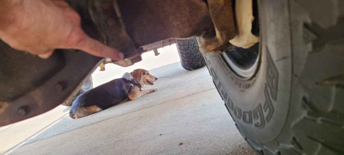

So I thought I'd put in the manual hubs. I jack up on crossmember that surrounds the front diff, pretty sure on that. Where to put jack stands, best place is radius arm bracket? Looks like it from the clean spots there.

I just put the stands underneath the beams out toward the wheel
I usually jack here, or as close as possible.

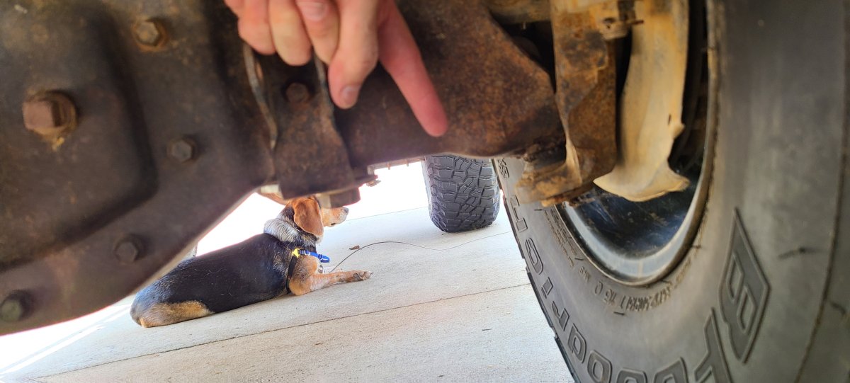

And jack stand here.

Just saw this in the shop manual - "never jack on the differential housing" (front). But if I jack on the beam that goes around the diff housing that's ok, right?
Not clear what you mean 'beams' can you call it a part name, thanks?
They jack goofy if you go under the pumpkin anyway... I just put the saddle of the jack under the radius arm lower bolt (in Eric's pics) and go from there, doing hubs you aren't going under the thing just do one corner at a time and leave the jack there assuming your jack doesn't leak down too bad... Hopefully you have 6 ton jack stands so they're tall but you can just go to the frame, leave the jack under the axle though or it gets floppy...
I wouldn't worry about the washers holding the hubs on, unnecessary... it's 3 seconds to put the hub back on if it falls off... They were there from the factory so it could go down the assembly line without them falling off...
Beams = Axle Beams. These are the pieces that are mounted crosswise and the spindle assembly bolts to them. The driver side beam contains the differential. Ie; TIB = Twin I-Beam suspension (rwd) and TTB = Twin Traction Beam, the 4x4 version of TIB
Radius Arms = the member that bolts to the axle beams right behind the spindle assembly and run toward a mounting point on the frame under the front seat area.
I do sometimes just leave the jack in place and put a jack stand under the frame behind the front rear wheel as a safety catch, like Scott mentioned
