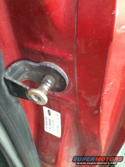

Do the '91 striker plates use the plastic around the striker bolt when the door closes? My '89 has them but both are missing from my '91. Both broken off? I just want to make sure before I put a new piece of plastic on.

Striker bolt
picture of striker on my '91. Should it have the plastic sleeve?
edit: Excuse my earlier post...the strikers do need the plastic on them, I'm assuming your doors rattle a bit on that truck without the plastic on the striker, replacing the plastic should solve it, I had that problem on another Ranger I had.
