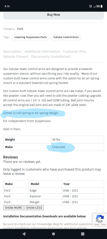

As for the parts themselves this is on one of the listings:
That is for the lowers. Maybe they would bolt in, but it doesn't look like they are good for torsion bars. Perhaps for someone bagging their truck? Seems like they are made for coil spring trucks, but I don't know if the attach points are the same. Seems like I've heard that they are not.
