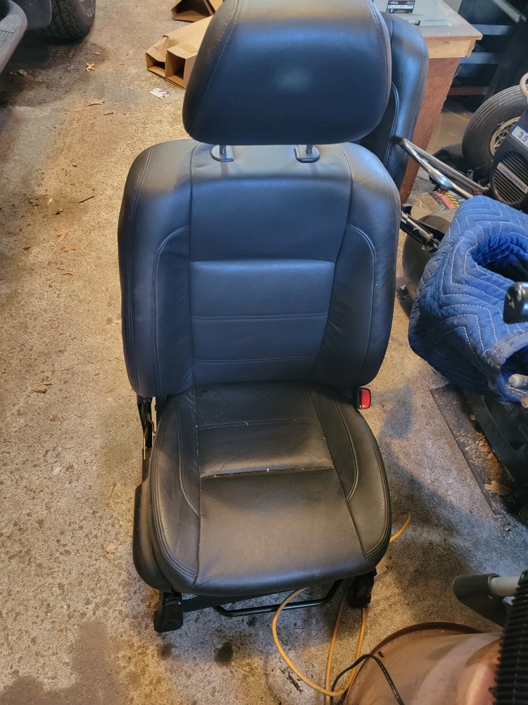

Agreed! My wife hated to get into it for that very same reason. I installed nerfs in order to help her, but still she complained. That motivared me to lower it. It was better, but still a bit of a climb, Leather seats also helped. She prefers leather anyway. They also help with the "slide." I bought these on craigslist for $200. They are more comfortable too.
