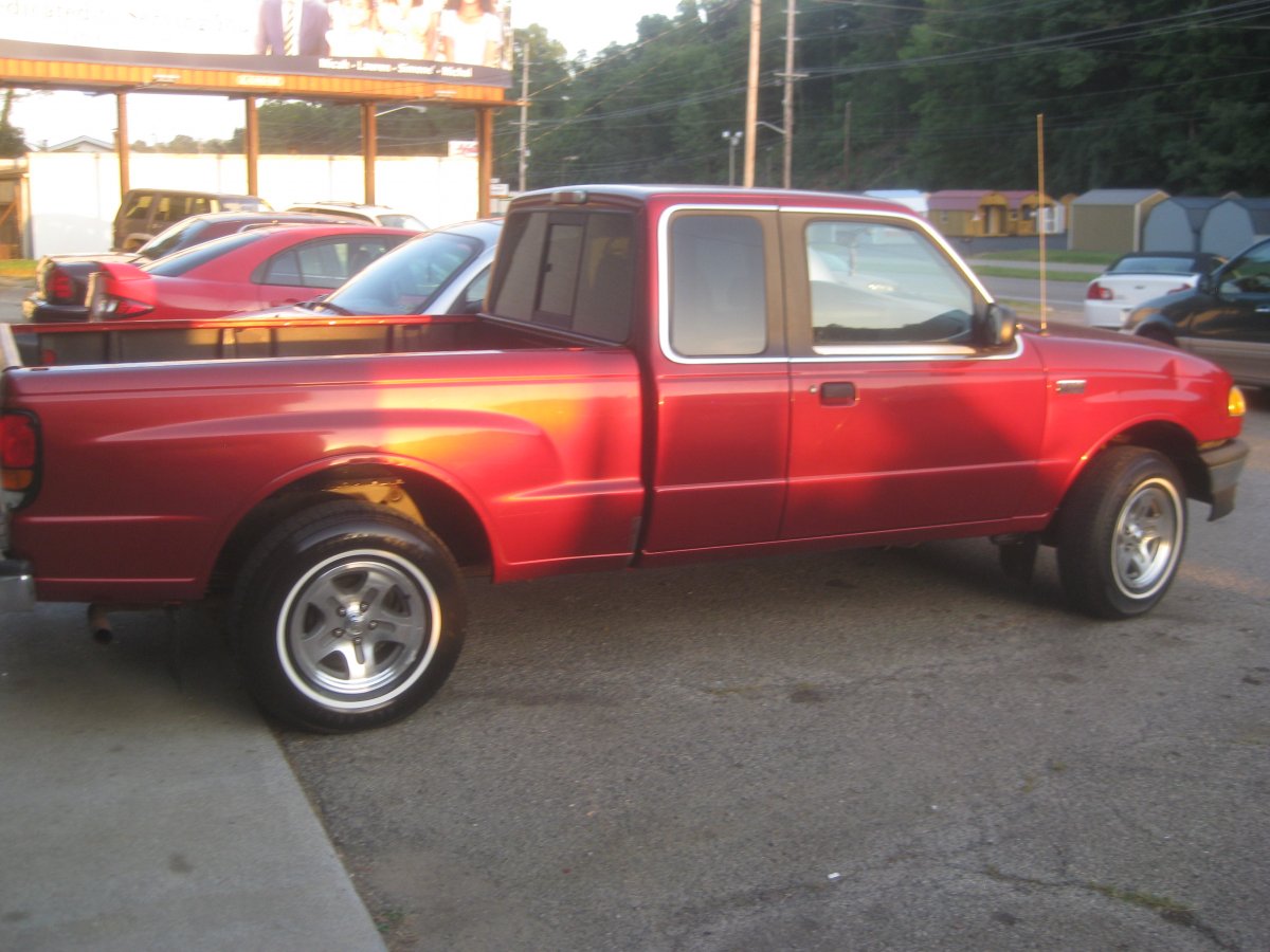

Looking at a decent '99 Mazda B3000 with extended cab (not 4-door). Hoping you guys can help me with a coupld questions before I make final decision to buy.
1. The little doors that open behind the actual doors, the plastic mount / face plate on the door jamb where the cable goes through is broken. You can still open the doors if you hold your fingers on the thing to keep it in place, but, it's obviously not right. How expensive are the parts to fix, and how hard is it to do? I already talked the guy down some so I hate to keep niggling about things if they aren't serious, but if it's a major pain to fix this then I might ask for more off the price. Just trying to get a rough idea on it.
2. How do you tell where it was made (what country). Just curious about that as I've hear that can affect build quality.
3. VIN is 4F4YR16V6XTM47630. When I try to look this up in Carfax or Edmunds they tell me that's not a good VIN. However when I got quote from my insurance on cost to add it, they say the VIN is good. What gives with that?
4. It has only one key with it. What's the best way to get a second key made?
5. My g/f says she heard "ticking" noise, mostly on startup from cold. I myself think this is the injectors, I heard the same sound on other vehicles I had with F.I. It's not really loud. I just want to make sure I'm not hearing something else weird, and, if there are any particular places or things I should listen please let me know.
6. Are those alloy wheels an option or are those aftermarket? Rest of truck looks totally stock from what I can see.
7. Where's the best place to get a shop manual for it?
I'm new to the forum and if you all can help me out with this I'd really appreciate it.
Pic of vehicle is attached. Zero body rust anywhere. Some dents (you can see the worst one) and scratches. Nothing really bad though. Probably the paintless guys could fix that one on the front fender, if not, no biggie to me.

#1. You can get those parts from RockAuto or anywhere like that or a Junk Yard.
#2. I don't know, but I think all of those trucks were made in USA.
#3. Recheck the "I's" for "1's" and the zeros for "0's" and there was a guy that could do the deep VIN search, but there is a way to deciphe3r your VIN on the interweb.
#4. KeyShop / Locksmith
#5. If it ain't tickin', how do you know it's runnin'? lol
#6. Those are Mazda "B" specific as far as I know
#7. if it does not have an owner's manual in the glovebox, E-bay or Amazon or maybe someone on here has one for sale. As Far as a "shop" manual, Haynes/Chilton will do, but experience tells me, those things can be WRONG AF.
Maybe someone can answer some of these better than me, I'm no expert at tall.

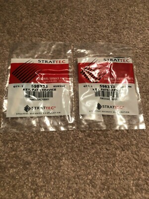

You can pick up a spare key blank online - you'll need either an OEM or Strattec brand as some of the third party ones really are junk. As long as you can get it cut to match your existing one by any lock shop, I can help you with programming it to your truck (we're in the same town, so I can physically do it in person if you're up for that and we can coordinate schedules). Here's some more info on that:

Bought it, filled the tank, good to go. Yeah I do have the little owner manual.
I looked at the rear doors more and the deal is that you can open them, but you have to hold the little grommets in place, they are not seated in the door jamb. What they do, which you surely know, is they keep the cable sheathing from pulling through the holes. If they aren't there then you can't get tension on the cables and that's the issue. It looks like all I need is new grommets and then I'd have to take the cable off to get the new grommets over it. I think that sound correct.

You can certainly check with Berglund for a key blank. I don't know if they'll sell you one directly or not. If you order online, you'll need the Strattec H72PT. They're cheap if you dig around too. Here's a two pack for $10.50:
The harder part may be getting it cut to match your current one. Some places are finicky about that sort of thing since there's a security system involved and they're not doing the programming to make it match. I used Hixson in the past, but they closed in the last year or two.
