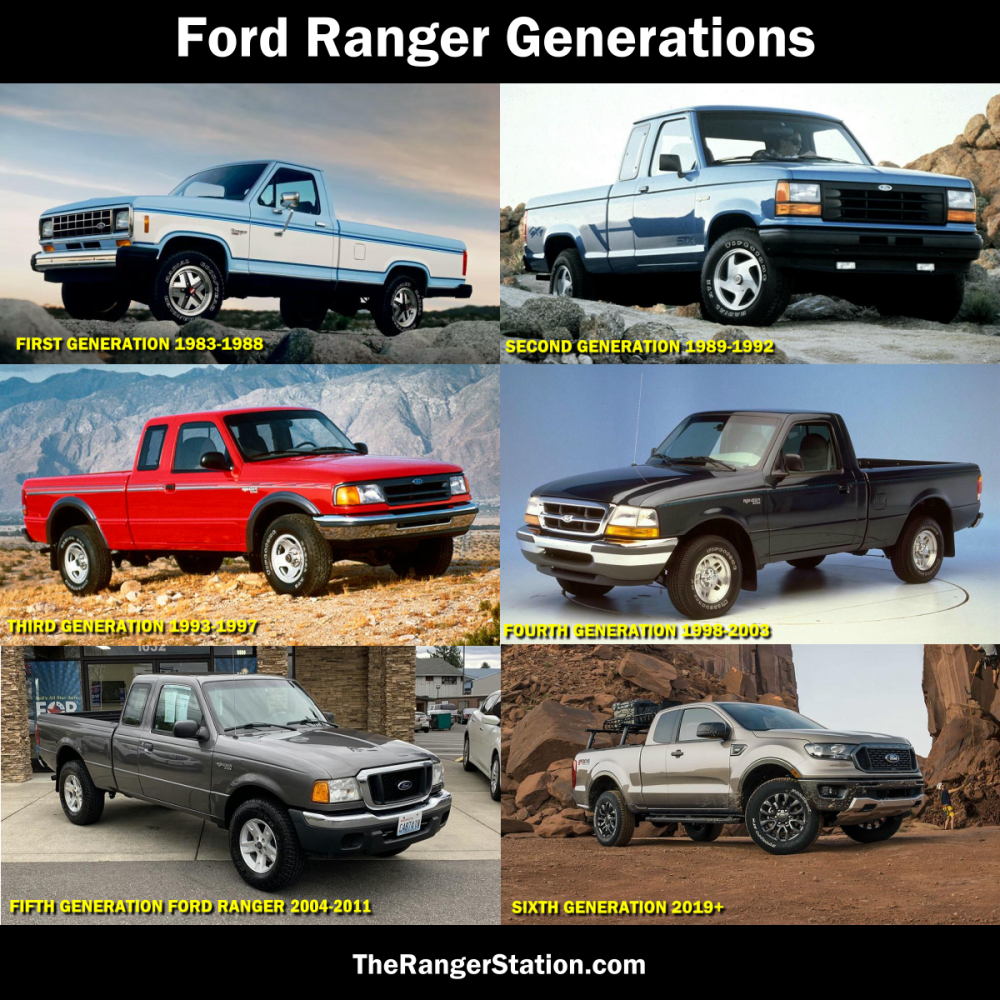

Will the bumper of a Gen 4 fit on a Gen 3? Will the brackets like me up to the frame or was the frame widened?
i need to learn the cut off on the years. if you have measurements, and my son didn't take my 04 to work, i can measure against mine to compare
Only the front portion of the frame changed. So, dimensionally, it should fit. Brackets and mount holes might be different.

Ranger frames widths didn't change, 1983 thru 2011, body got about 2" wider in 1993 and up, so cab/body mounting points are different
The 6 Bed mounting bolts/holes were the same, 2 extra bolts/holes were added in 2007 or so, but original 6 holes still lined up, so 6 hole bed will bolt to 8 hole frame and visa versa
But rear bumper on Flareside(stepside) is narrower than styleside, just like the tailgate is, either width bumper will bolt to frame, but for "looks" it would be best to match width, lol
That link leads to the super duper top secret staff forum... probably a no go for members to see.
Oops. Sorry. I just googled it and saw that come up and thought “Gee. this is exactly what He needs.” Plus, it included our really cool “we did this” generations photo from last year’s roundup.
i like the front end on the first gen. totally off topic post, to start the new path of this thread :)
