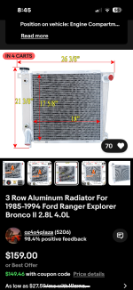

Hey guys I’m wanting to replace the radiator in my ranger and I’m wondering if this would fit my truck? Or how many cores I need or could fit? I’ve got a 91 4.0 auto with ac so it’s the “heavy duty” radiator I believe. Would this be a good option or should I just get an OEM style one with plastic
This is the current link to the one I’m looking at https://ebay.us/m/faXZDR

Or there’s this cheaper one that is two core and the seller offered me 122$
If this would be sufficient I would maybe get this cheaper one.
Also this is probably important but I’m lifted 4 inches and I’m on 31s if that affects anything because of the tire size
