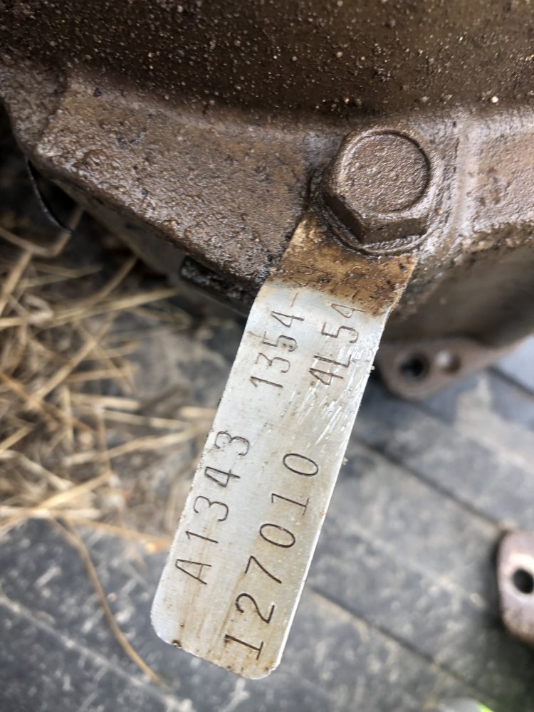

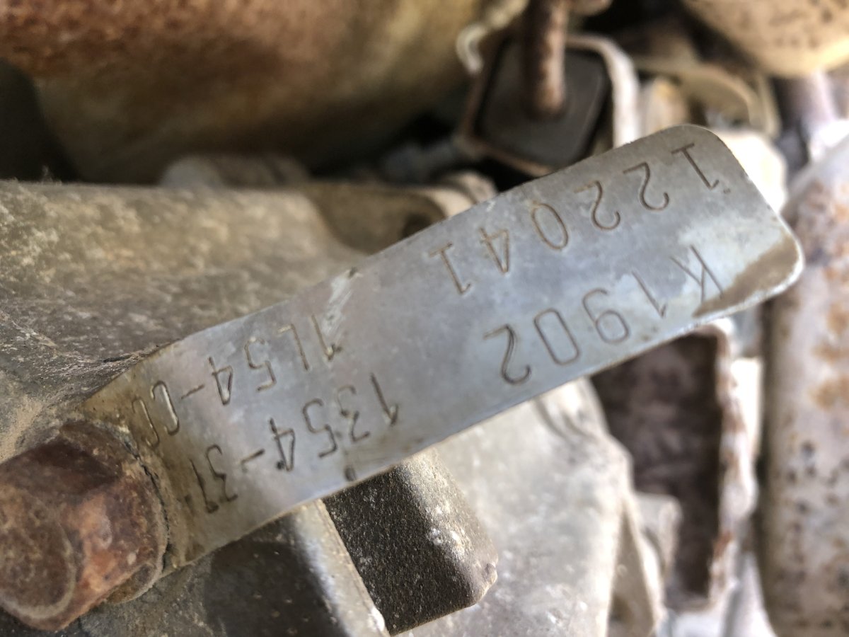

I guess I have a two part question on another Ranger for a transfer case swap.
Friend has 2000 with 3.0 with a bad 1354 transfer case. Automatic tranny.
I recently pulled a transfer case 1354 out of 00 or 01 with 4.0.
My question is will my transfer case fit his Ranger?
Took pictures of the tags.
Easy one 1st: 1354 transfer case came in 2 variants - manual and electric shift; no difference 2.3/2.5/3.0/4.0 or auto vs. manual transmission. You may find some differences in input and output connections, but you can always swap from old to new as the shafts are same.

Yes, transfer case will fit
