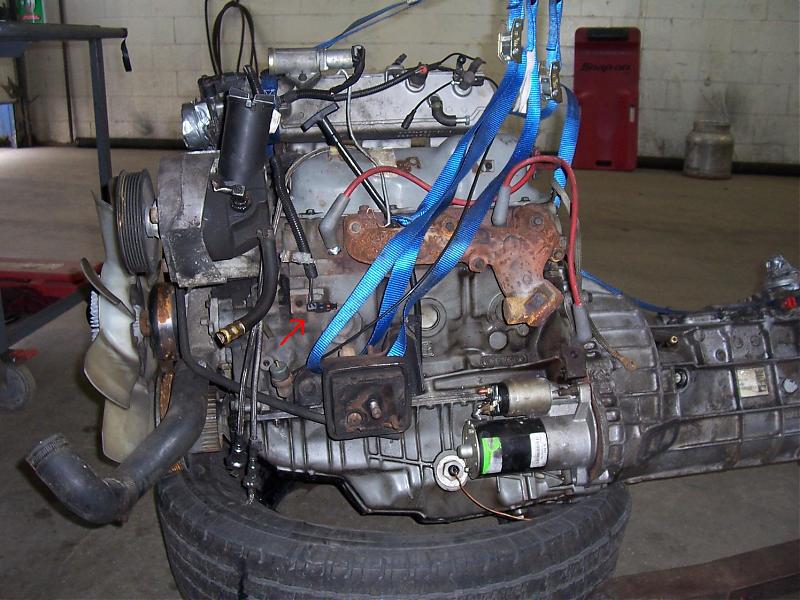

i have took the motor apart all the way don to the block and put it back together again twice just to see if i can find where the harness plugs in at and nothing on mine there is one big harness which has the 6 fuel injectors connectors and this mystery connector that looks almost just like the fuel injector ones but it doesnt belong on the fuel injectors thats what is confusing !!!!!
How much room does it have? The injectors all pretty much point to exactly where the injectors sit with 1/2" of play or so. Is this on the driver side, passengers side or at the back? What about the camshaft position sensor. That is at the back of the motor right? It is out of the way where you wouldn't see it really easy. I dont know what the harness looks like but it seems as if its close by. What is in vicinity of the harness? Also do you have a picture?
does it look like this one? If so, that's the one that goes towards the carcoal canister mounted below the driverside headlight
