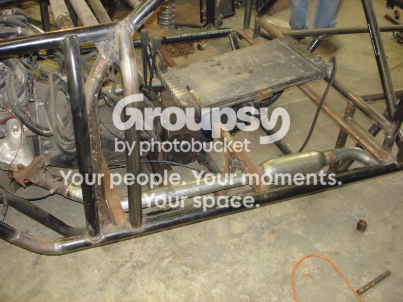

He wanted me to start out buy cleaning up the back part of the frame, and making it look better and redoing some of the suspension, then making some skins for it. SI cut off the back part of the frame and decided to make some tube work to clean it up.
After further inspesction and looking at it, I noticed the motor was in it crooked and the angle from the front of the motor to the output on the transfercase was a hugh downward angle. As in the motor mounts were 3" above the frame and the output on the transfer hung down 8-10" below the frame.
So I decided since the motor mounts and everything else was welded in and the floor was paper think after cutting off the rocker panels then I would just cut the whole cage off the frame and scrap it.
So I went and got a few sticks of 2" tubing and put them on the floor, then I bent them to start the chassis,
I slowly started attaching it to the exsisting cage.
The main goal was to make a flat belly and keep everything tucked up tight. IT was about this time that he came over one day, (he lives about 45 minutes from me) he got a sick look on his face when he saw his frame all cut up laying out in the driveway. :D But after he saw it he was alot happier.
Boat sides were a must also, because he plans on trying to following me :D
Next I made some braces for the seats and put the exhuast tcked up in the boat sides.
Finally a few weeks ago I was running out of time and he was bored and wanted soemthing to do, so he came to get it to take it home and do some of the work himself, and start figuring out where he wanted to mount his axles and some of the guages and he was gonn cut out some of the sheetmetal for the dash I made.
He is going to bring it back when he gets ready for hanging the axles and when I get this other project out of my shop. Here it is sitting outside waiting for the trailer to take it home

No problem LOL. What are you using for a tube bender? I like the look of those nice smooth bends. We usually heat our tubing and bend it around an old steel rim. It's a real hillbilly way to do it, but for all the tubing I bend it's the best way I know of.
I have a hydrolic bender, no I am not rich nor did I drop a bundle on a bender and stuff, I got reall lucky and found a shop that was going out of business, took advantage of it and put in a silent bid for some of their equipment, so low that I didnt plan on getting it, but I did.:headbang:
