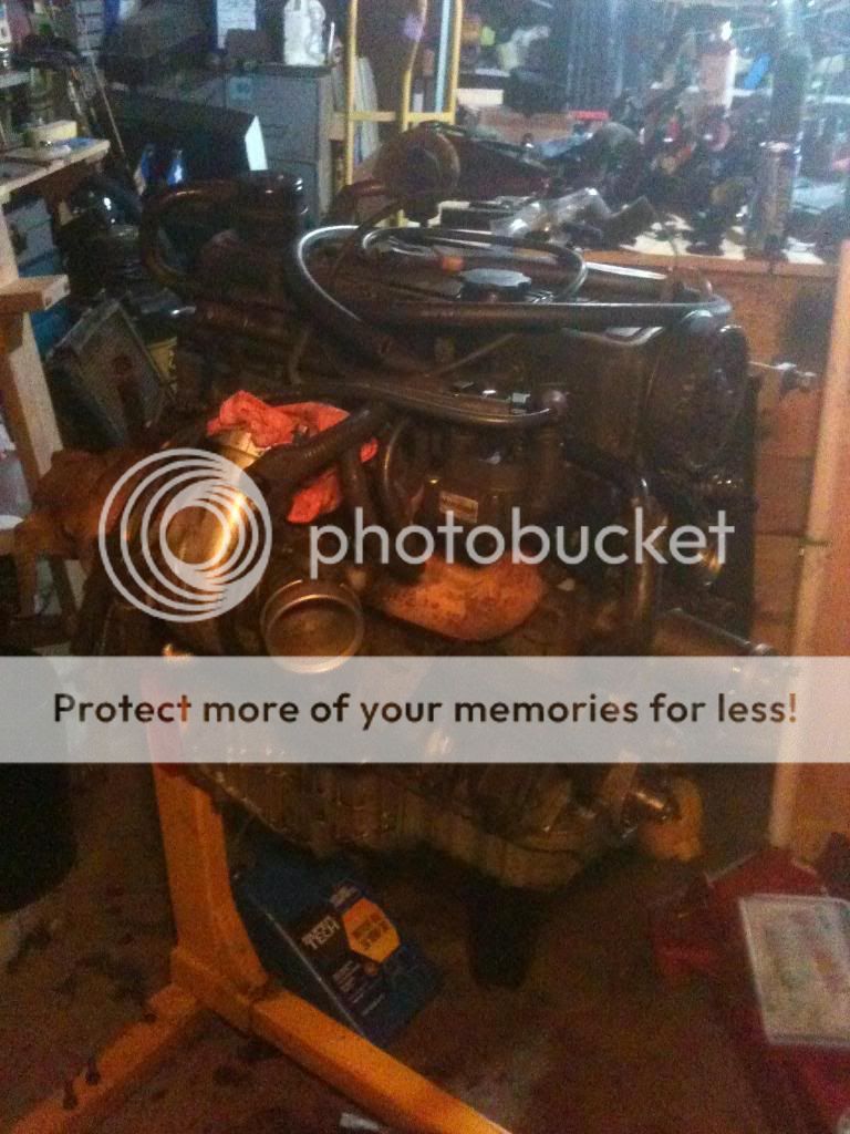

Got the head off my engine tonight, so far everything on this engine looks to be in GREAT shape!!! not sure how, but it looks like my engine was running perfectly? Combustion chambers have some deposits but not bad, valves are a good color and not too much build up, spark plugs are a good color, cylinder walls have some cross hatching and no super bad hot spots, I'll borrow the straight edge from work tomorrow and see if my head is warped like the other one... Apparently there's a burr on the rear of the cam by the retainer plate, so I have to do cam bearings but they didn't look too warn. I'm thinking this engine is as fresh as the guy told me when I got it, he said ~60-80k so just broke in... I've put about 20k on it since I put it in, should be good for a lot of years after I get it back together
