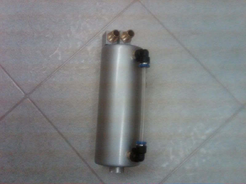

Figured since Id be toying with the cooling system, Id upgrade the thermostat and housing. The ford factory stamped housing is known to be crap, not seal, and rust out. So I got this housing from dieselsite, it is a machined billet thermostat housing bling bling! As wel from dieselsite is a 203* thermostat. It is made by International, and is a short stem unit that will not cut off the internal pump bypass, as the stock long stem units do. You may be wondering why Im bumping to a warmer thermostat, well long story short, International acutally designed these motors to run at about 203*, and up until 97, these are the thermostats that they had in them. The engines run better, and some guys have even seen an improvement in mpg. Either way I wanted to change it, and from my research this was the way to go.
I got one more thing in the mail, but it will be a bit of a surprise. There is a VERY common problem that all intercooled 7.3's are affected by, due to a stupid design. Hence I will use the following item and a bit of hardware to fix it........5 points to whoever guesses what Im going to use it for.
