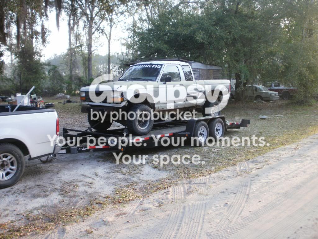

Ok time for an update of sorts. Haven't done any work to it in a while but progress has been made in a way. Got to thinking why put it together with the stock drivetrain when I intend to do the 4.0 swap eventually anyhow so I went to searching for a donor and finally found one.
I used the tires and rims off stepchild to bring it home. It actually sits on a set of 36's as seen in the next pictures.
As you can see I had to take it mudding...need to make sure there is no problems with the drive train right? Lol.
After running this thing plans have changed a little. Still gonna do the 4.0 swap on stepchild using the engine out of the white Ranger however I not gonna use the axles. Gonna leave them in the Ranger and use a different set. The Ranger will then get a v-8 and be used as a bogger truck for the local mudbogs, trailered there and back.
